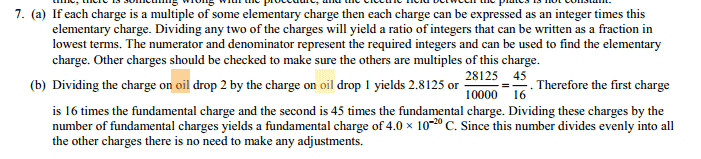

so i found this section from the website, (from grade 12 physics textbook surprisingly)
They did a sample calculation for oil drop 1 and 2. and got 45/16=n2/n1
But when I use the method they described for oil drop 1 and 3 instead, I get 3.3750, which can be written as 3375/1000=27/8, which makes the fundamental charge smaller than the one calculated in the sample calculation. but they are saying that it should be the same?
Can you quickly go over the pictures I posted along with this thread?
Thank you :)

DarthMatter's advice is stunningly bad. If you were to follow it in a class that I was teaching, I would flunk you.
1) The point of a lab is not to see if you can find the "correct" value in a book somewhere and write it down.
2) Converting N measured values into N^2 pairs of values does not add information. It just adds complexity to the analysis.
For drop 1 and 3 I get 10.8/6.4=1.6875=16875/10000=27/16.
but that value doesn't make too much sense to me since, drop 2 has less charge than drop 3, but has 45 charges... I have no idea why the author published such answers/methods on a textbook...
