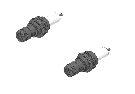

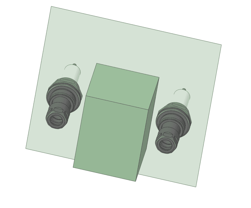

Thanks for your reply. What I'm trying to model is the electric field between two connectors. I've attached a screenshot of the 3D models. Basically, I would like to determine the what spacing I need between the two. First, I would like to model them in air. Next, I would like to include the enclosure which will be let's just say nylon for now. At the end of the day, I am trying to answer the following questions.
1) What equations should I use to estimate the E-field intensity between the two in air.
a) what equation should I use for electrostatic assuming AC? I was thinking of using an equation that considered electric field between two cylinders which would be a large simplification for this since it would probably be true only for a long cylinder.
b) What equation should I use for electrostatic assuming DC? I know that this would be considering the volume resistivity in air
2) What equations should I use to estimate the same points as in 1 a,b but with a piece of solid dielectric between the two. I know this will depend on the volume resistivity of the solid, as well as air. I think air can be tricky since it changes depending on temperature, humidity, elevation, etc. I also know this will be a lot more complicated since it will be a mixed insulation system but will hopefully be manageable.
3) I would like to simulate the points from 1a,b and 2a,b to see how close it got. I hope that explains what I'm wanting to do clear enough. I've attached two pictures to describe 1 and 2.

Simulation of a safe separation is unwise since the breakdown of electric fields is partly environmentally determined, so somewhat unpredictable.
A simulation will give you false confidence.
The alternative is the routine calculation of all possible leakage paths when subjected to contamination and ageing of materials. The calculation required will depend on the application.
The advantage of a dielectric wall is that the surface leakage path is lengthened. But the joint between that wall and the bulkhead may become a weak point. High DC voltages attract contaminants to surfaces. Sometimes a coaxial cable is more reliable than a single conductor because the electric field is fully contained inside the cable and connector.

I see no advantage in the two insulated connectors.
The 10 kV rated connectors are part of a leakage path, a series voltage divider.
If the gap between the connector shells is more conductive than the internal connector insulation, then the connectors will be operating at more than 10 kV. That will degrade their insulation.
It is difficult to know without data on the construction of the connectors.

I cannot see what advantage insufficient insulation might be. You would do better with none, since all the potential would then appear across the one gap material. You could use bare Cu or Al tubes as conductors, a larger diameter will reduce the corona. Either way you will need a cage with an interlock switch on the access panel to keep people safe.
