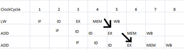

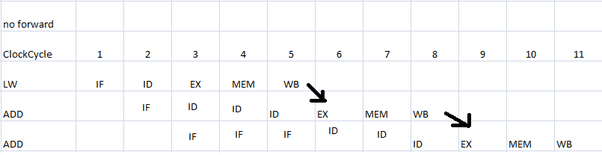

Assembly Code:
LW R1, 0(R2)
add R4, R3, R1
add R3, R1, R4
What are the dependencies
Fill the pipelining timeline if:
a. There is forwarding
b. There is no forwarding
N/A
With forwarding attempt:
Without forwarding attempt:
Am I filling the pipelining timeline correctly?
