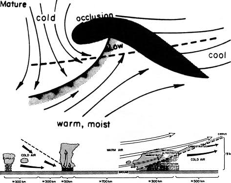

And then we have not begun to consider the effect of advection when warmer air masses lifts up when colliding with colder air masses, which is certainly not a instantenous process.

Now the big curly waving frontal clouds on both hemispheres are the ones associated with frontal advection caused by colliding air masses where the warmer masses are lifted above the colder masses and generate clouds in much the same way as basic convection does. As explained in their fig 5:
[ATTACH=full]128773[/ATTACH]
obviously it seemed justified to investigate if higher temperatures also generate more clouds (Clausius Clappeyron) and hence more reflection of shoft wave energy? In other words is there really much difference in feedback between tropics and moderate climate zones?
