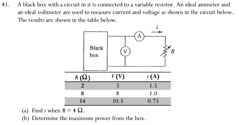

The question is showed as below.
I don't know how to find i when the resistor is 4 ohm.
I think it is quite difficult as the voltage is varying all the time.
So how do I find the current?

What sort of circuit might you replace the internals of the black box with in order to give you something to work with? You have several external data points you can use to determine the parameters of that circuit model (think: simultaneous equations, solve for required parameters).
