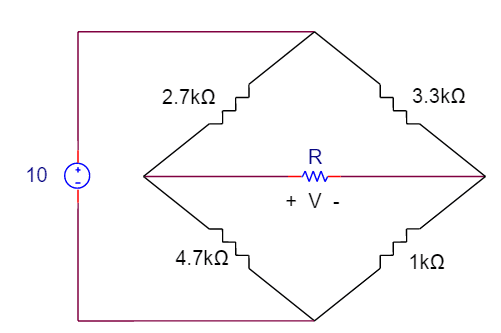

Using the maximum power transfer theorem, find the value of R which will result in the maximum power being delivered to R.
Bridge circuit with a 10 V source on the left, four resistors 2.7kΩ (upper left), 3.3kΩ (upper right), 4.7kΩ (lower left), 1kΩ (lower right), and a load resistor R across the centre branch with voltage V.
P_max= (V_oc)^2/4(R_th))
R_L=R_th
P_RL=(V_th/(R_th+R_L))^2*R_L
I have no clue where to even begin with changing this circuit to its Thevenin equivalent. I feel like there are 2 unknowns here (power and resistance) and I don't even know where to get started with trying to solve for R.

What is the usual procedure for finding a Thevenin equivalent?
