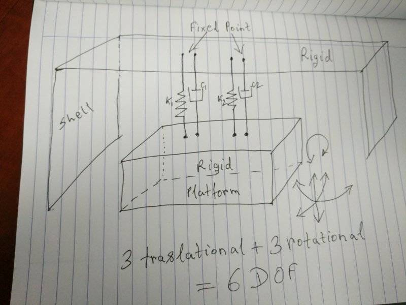

My target model will be an elliptical shell attached with a trapezoidal prism platform by a number of spring/dampers. The idea will be to model the movement of the platform in all three directions (x, y, z) as a function of time for different spring length, constant, damping coeff and locations where the spring is connecting the platform to the shell, for an external force that will be acting on the shell.
By doing this I should also be able to calculate the amplitude and frequency transfer from the shell to the platform via the spring system.
Hope these answers some of the missing links. Thank you for your time.

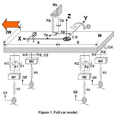

Have you worked on modeling simpler systems in the past? If so, what kind of systems? Have you looked at modeling slightly more constrained 3-D systems like vehicle suspensions?
https://arrow.dit.ie/cgi/viewcontent.cgi?article=1018&context=engscheleart
http://www.scielo.br/img/revistas/jbsmse/v30n1/fig01.jpg

Thank you for your input. My background is in modeling but mostly in the fluid dynamics domain. I have used Fortran programming during the earlier years but switched to Comsol software afterwards.
I have indeed looked at the suspension model, which I believe is also an example model in Comsol. This one and also the other for washing machine were a couple of good examples I think for the problem I am looking at.

We still need further clarification. How many degrees of freedom do you want to model for the platform? If the shell is not elastically supported, is this any different from the classic problem of a pendulum on a moving support? Seems like that is what you have here, unless I've missed something.
At the moment I would go for 6 DOF. Roll, pitch, heave and yaw for platform and two spring/damper that will make the platform hang from the outer shell. My degrees of freedom could go up if connect more attachments between the platform and the shell in future. This could very well be analogous to a classic pendulum problem as you mention.
Sorry I would add 2 more DOF to the platform for its sway motion along x and y-directions.

This suggests confusion about DOF. Attachments (springs, dampers) do not add DOF. The number of DOF depends on the number of coordinates required to describe the state of the mass.
Since you have yet to post a figure, I suspect we are wasting our time trying to answer.
I have thought about it a bit further and in this system there will only b total 6 DOF (3 translational and 3 rotational). In this preliminary diagram I just have the initial 2 spring/dampers attached to the platform that is free to swing in any direction. The points where the springs connect the shell to platform are fixed. Both shell and platform are rigid bodies.

So, you have several steps to work through:
1) Decide how you will describe the angular degrees of freedom (what kind of coordinates you will use);
2) Work through the system kinematics with that choice;
3) Write the kinetic & potential energy functions and the generalized nonconservative virtual work;
4) Apply Hamilton's Principle.
Bingo! the result.
