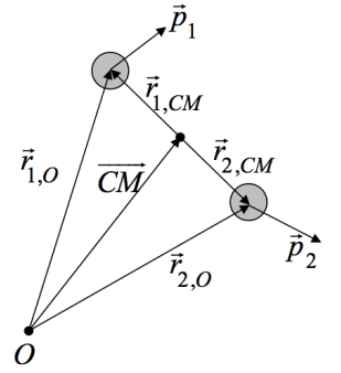

Imagine that you toss the drumstick of a turkey to your friend across a table. Approximate the leg as a baton consisting of two equal masses connected by a stiff spring. Let the masses, m and M, each equal 0.1 kg (we’ll modify this assumption later) and connect them with a spring of negligible mass and spring constant, k = 105 N/m. Let the initial distance between the centers of the two masses be the rest length of the spring, d0 = 0.15m.
You give the leg an impulse so that, as it leaves your hand, mass m has v1=<2.77, 1.25, 0> m/s and M starts with v2=<1.25, 4.0, 0> m/s.
Take the origin of the coordinate system be the initial location of mass m. Let the second mass be initially located at <d0, 0, 0>. Write a code to evolve the flight of the leg under the action of gravity, but ignore air resistance.
Ltrans = r x p
Lrot = I[itex]\omega[/itex] = MR2[itex]\omega[/itex]
This is where I'm struggling. I don't quite know how to approach this problem, at least not practically. Reading the book, while somewhat helpful, has not really seemed to make me capable of understanding how to go about solving this particular problem.
BTW, the code in question is in VPython, which is largely a logical language, the difficulties of which I'll deal with myself. My questions are more about the logic of this problem.
I will admit I cannot say I (fully) understand angular momentum, much less its interaction with spring force in this situation. I'm not looking for anything to be handed to me, but I'm confused enough by all of the concepts I'm trying to grasp that I feel I need guidance in baby steps. Any help would be greatly appreciated.

As rcgldr indicates, you can treat the motion of the common mass centre separately from the rotation/oscillation and simply add them together at the end to find the coordinates of the two masses.
Sorry for my display of daftness, but what would I be adding to obtain the two sets of coordinates?
Also, I still don't have a practical idea of how to start this problem, and I still don't know what "[considering] the spring as compressable as well as expandable from it's "rest" state" entails, computationally.
Model the movement of the common mass centre. This is a simple 2D trajectory problem.
Model the motion of the two masses relative to their common mass centre. For this you can treat the common mass centre as stationary, so you only have to consider the two masses in a kind of orbit around each other.
To find the coordinates of a given mass at a given time, add its relative position to the position of the common mass centre.
That just means the force in the spring is always proportional to the difference between its current length and its relaxed length. Otherwise you have nonlinearity where the spring becomes fully compressed.
The hard part is going to be the rotation/oscillation. See if you can write some equations around that. Bear in mind that the common mass centre stays put for this, and there's a fixed relationship between the two distances from it.

Consider one mass in relation to the common mass centre (CMC). Let its distance from that centre be r = r(t), and the rest length of the distance be r0. Let its angular velocity about the CMC be ω = ω(t). (Motion is all in one plane.) What equations can you write relating r, ω, acceleration of the mass and the tension in the spring?
Are you familiar with these equations?
##F_r = m \ddot r -mr \dot {\theta}^2 ##
##F_{\theta} = mr \ddot \theta +2m \dot r \dot {\theta} ##?
Those equations do not look familiar, but I'm admittedly a bit thrown off by the dots above some of your terms. I'm not sure what they represent. Nevertheless, I'm also not sure what the two forces represent. In notes I took when the problem was introduced, we were told the only two forces acting on the masses were gravity and spring.
Also, I attached an image that's part of our assignment which would probably help with some notation.
BTW, I do want to thank you for your patience and for spending your time helping me out. It's greatly appreciated.
The dots denote differentiation wrt to time, so a double dot shows an acceleration. In terms of angular velocity, ω, ##\dot \theta = \omega##; ## \ddot \theta = \dot\omega = \frac{d \omega}{dt}##. For the motion relative to the CMC you can ignore gravity, so the only force is that from the spring. That will be Fr in the equation. Fθ will be 0.
You also need an equation relating Fr to r and the spring constant.
