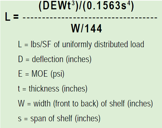

For my purposes, I believe it represents the stiffness of the material I am using. I use the MoE when figuring out which material I need to use for cabinet shelves to maintain a shelf load of 50 lbs/sf. This is the Formula I use to figure this out:

OK. So you are using the Young's modulus E in a beam bending formula, and you are looking for an equivalent value of E to use in the formula for a symmetric laminated composite beam. I could derive this for you, but we are not supposed to do that in Physics Forums. At the same time, your background doesn't seem to be sufficiently extensive for me to help you derive it on your own. For bending of your composite, the equivalent E is going to be different than for tensile loading. The only thing I can suggest is that you get a book on composites, or Google "bending of composite beams."
