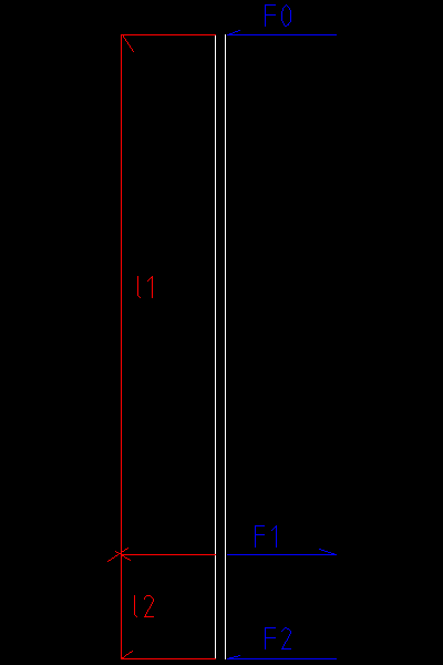

There is an unstayed mast which is 3m long, supported at the bottom and at 0.5m from the bottom.
Sail area is 10 m^2, design wind speed is 50 km/h.
It is made from glass epoxy composite.
The base fiber is 300 g/m^2 glass textile. E-glass, 2/2 twill.
The inner diameter is 40mm.
Develop the lamination schedule for the mast.
Force of wind on the sail:

known values:
[tex]$<br /> A = 10 m^{2} \\<br /> AWS = 17.3611111111111 \frac{m}{s} \\<br /> C_{s} = 1.1 \\<br /> Rp_{02} = 160000000.0 \frac{N}{m^{2}} \\<br /> l_{1} = 2.5 m \\<br /> l_{2} = 0.5 m \\<br /> \rho = 1.2 \frac{kg}{m^{3}} \\<br /> ri = 0.02 m \\[/tex]
Though F0 acts in the center of the sail, I have choosen to account for it at the top of the mast for additional safety margin and ease of calculation.
[tex]F_{0}=\frac{1}{2} A C_{s} \rho AWS^{2}[/tex]
[tex]F_{1}=- \frac{F_{0} l_{1} + F_{0} l_{2}}{l_{2}}[/tex]
[tex]F_{2}=- F_{0} - F_{1}[/tex]

Questions:
- Is the choice of tensile strength sensible?
- Are all the design choices (putting sail force at the top, adding layers to the schedule) safe?
- Are there any flaws in the calculations or logic?

Oh, forgot to mention that AWS is 1.25 * design wind speed according to GL scantling rules.
