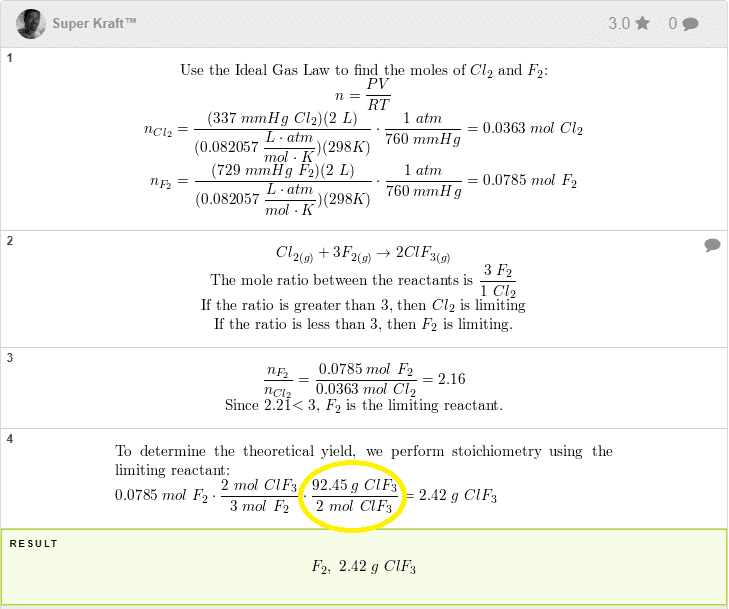

79. Chlorine gas reacts with fluorine gas to form chlorine trifluoride.
Cl2( g) + 3 F2( g) = 2 ClF3( g)
A 2.00-L reaction vessel, initially at 298 K, contains chlorine gas at a partial pressure of 337 mmHg and fluorine gas at a partial pressure of 729 mmHg. Identify the limiting reactant and determine the theoretical yield of ClF3 in grams.
PV=nTR
where
P=pressure
V=Volume
R= gas constant
n= moles
T = temperature in kelvins
So essentially I followed pretty much what is in the picture
here in this solution.
https://www.slader.com/textbook/9780134162430-chemistry-a-molecular-approach-4th-edition/242/exercises/79/
My question is essentially why does he do the 0.07XXX mol f2 * 2mol clf3/3mol f2 * 92xx g/2mol f2 = answerfor the weight. I always thought as the mole to grams as a 1 for 1 sort of deal. That is if something has a mass of 95.45 amus that means that 1 mole weighs ~ 95.45 grams. However, he divided by 2 again where one would normally not because you are essentially dividing mass per mol by 2, making the molecule lighter than it really is.

They should not have divided by two.
