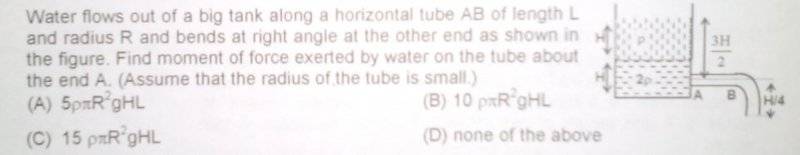

Bernoulli's equation : ##P + \frac{1}{2}ρv^2 + ρgh ## = constant
The pressure at the interface is ##P_{int} = P_0 + ρgH## .
Applying bernoulli's equation between point at the interface of two liquids and exit of the tube .
##P_{int} + ρg(\frac{H}{2}+\frac{H}{4}) ## = ## P_0 + \frac{1}{2}(2ρ)v^2##
##v = \frac{\sqrt{7gH}}{2}## .
This doesn't give correct answer .
.What is the mistake ?
Thanks
Did you use the correct density on the left?
Ok .
It should be 2ρ . It gives ##v = \frac{\sqrt{5gH}}{2}## which again seem incorrect .

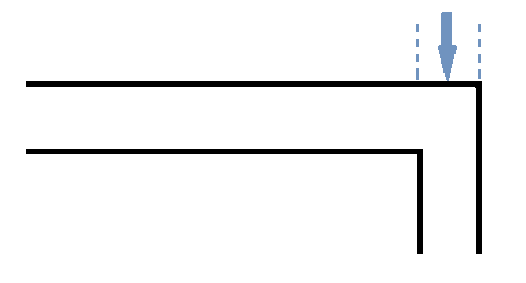

You'll need to consider the atmospheric pressure acting on the tube over the region shown below.
But this pressure is not acting directly on the fluid ?
Right. You are ultimately interested in the net torque on the tube. (I believe this is what the problem is actually having you calculate). I will let you think about this.
If I consider (tube+fluid flowing through it) as system , then since the system is in vertical equilibrium , the force due to atmosphere at the top of the bend is balanced by the pressure force at the exit .
Is this a valid reason why P0A should not appear in the expression for vertical force and ##F_v = -ρAv^2## only and not ##F_v = -ρAv^2 - P_0 A## ?

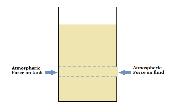

A similar confusion has occurred in the following set up . Again this a standard problem/concept in fluids .
Consider a container with fluid (density ρ) having a hole of cross section area A at the wall of the container(towards the right side), a distance h from the surface of water. The speed of fluid coming out will be √(2gh) and the reaction force exerted by fluid on the container is given by ##\rho A v^2## . This is a standard result derived in books :rolleyes:.
Now , there will be two horizontal forces acting on the fluid , that due to container and force due to atmospheric pressure acting towards left . The horizontal rate of change of momentum will be ##\rho A v^2##.
Take right direction as positive , ##F_H - P_0A = \rho A v^2## i.e ##F_H = \rho A v^2 + P_0A## . In other words the force exerted by fluid on the container is ## - \rho A v^2 - P_0A## .
In this case also I get an extra ## - P_0A## term o_O
Again a discrepency in a standard result :H??
Please help me resolve the confusion .
At least naively, I think the discrepancy is similar to before. See the figure below. The horizontal force on the fluid includes the external atmospheric pressure at the hole: ##-P_0A##, as you note. This leads to your result ##F_H = \rho Av^2 + P_0A## for the horizontal force that the container exerts on the fluid. So, by the third law, the fluid exerts a horizontal force of ##-\rho Av^2 - P_0A## on the tank. But the atmosphere exerts an unbalanced force to the right of ##+P_0A## on the tank. So, the fluid and atmosphere together exert a horizontal force to the left on the tank equal to ##-\rho Av^2##. Therefore, effectively, the discharge of the fluid results in an overall "reaction force" of ##-\rho Av^2## to the left. If the tank is resting on a frictionless surface, you would need to exert a horizontal force of ##+\rho Av^2## on the tank to hold it at rest.

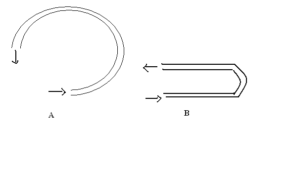

Brilliant analysis :smile: . Thanks a lot . It seems that ##\rho A v^2## is not the force due to ejecting fluid on the container rather it is the net horizontal force on the container due to ejection of the fluid . Right ??
Please see the attached image .
In figure A) fluid moves through a pipe which is 3/4th part of a circle whereas in B) the fluid moves through a U tube .The tubes are at rest on a horizontal table which means there must be some support to keep them at place .The direction of fluid flow are as indicated by arrows .Towards right and upwards is positive .
1) For part A) would you agree that "Horizontal Force exerted by tube on liquid " will be ## - \rho A v^2 - PA ## , where P is the pressure in the fluid at entry ?
2) For part A) would you agree that "Vertical Force exerted by tube on liquid " will be ## - \rho A v^2 - PA ## , where P is the pressure in the fluid at exit ?
3) For part B) would you agree that "Horizontal Force exerted by tube on liquid " will be ## - 2 \rho A v^2 - 2PA ## , where P is the pressure in the fluid at entry/exit ?
I think I can help with this. We are doing a momentum balance on the fluid in the control volume between the exit of the tank and the exit of the tube. First, the vertical direction. You correctly determined the force that the pipe exerts on the fluid in the vertical direction as ##-p_aA-2\rho v^2A## (aside from the weight of the fluid, which should also have been included).
If the pipe were empty, except for air, and we put an imaginary surface across the exit cross section, and we did a vertical force balance on the pipe (with this exit cross section included), we would have found that the net air pressure force exerted over the entire surface of the pipe would have been zero (for equilibrium to prevail). In this case, the vertical force over the exit cross section would have been ##p_aA## upward, so the vertical air pressure force over the remaining part of the pipe surface (aside from the exit cross section) would have had to have been ##p_aA## downward. But the vertical air pressure force acting over the remaining part of the pipe does not change when fluid is flowing. So, if we include this in the vertical force balance on the pipe when fluid is flowing (together with the force from the fluid), the net downward force of the air ##p_aA## is just canceled out by the upward pressure force from the fluid ##p_aA##. So the net resultant vertical force on the pipe when the fluid is flowing is just ##2\rho v^2A##.
Of course, as TSny has correctly pointed out, the weight of the fluid in the pipe should also have been included in the vertical force balance on the fluid within the control volume.
As far as the horizontal analysis is concerned, I will only note that the fluid pressure at the entrance cross section of the pipe is ##p_a+(2\rho)g\frac{H}{4}##. Virtually all the pressure changes leading up to the entrance cross section (exit cross section of the tank) occur within the tank.
Yes, I agree with all of these. Again, though, I believe that if you also add in "unbalanced atmospheric pressure" on the tubes you find that all the PA terms go away.
