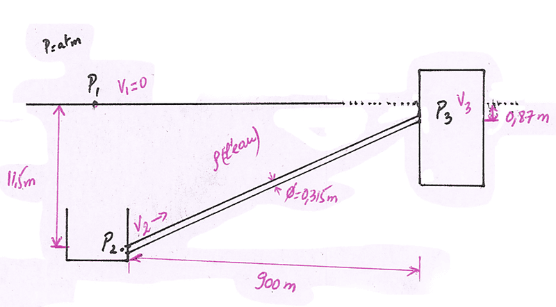

A seawater collection system consists of two tanks connected by pipe 900m long and 31.5cm in diameter
The pipe inlet is on the seabed at a level of -11.5m and the pipe outlet to Tank 2 is on the beach at a level of -0.875m.
Calculate in detail the water velocity and water flow at the outlet
Both point 1 and 3 are in open aire (Only under atmospheric pressure).
See the drawing for more explanation.
P_1+1/2 ρv_1^2 + ρgh_1 = P_3+1/2 ρv_3^2 + ρgh_3
Hello everyone;
Please need some help to check if my calculation are correct (and if possible some explantation)
Hand-drawn diagram of a water tank on the left connected by a pipe sloping down to a box on the right; points P1, P2, P3 marked, with 11.5 m height, 900 m horizontal length, pipe diameter 0.315 m and 0.87 m height labelled.
Bernoulli's equation between point 1 and 3 is given by:
P_1+1/2 ρv_1^2 + ρgh_1 = P_3+1/2 ρv_3^2 + ρgh_3​
P_1 = P_(atm )
v_1= 0 m/s
h_1= 0.875 m
P_3 = P_(atm )
v_3= ? m/s
h_3= 0 m
P_(atm )+1/2 ρ(0 m/s)_1^2 + ρg(0.875 m) = P_(atm )+1/2 ρv_3^2 + ρg(0 m)
ρg(0.875 m)=1/2 ρv_3^2
(9,81 m/s^2 )(0.875 m)=1/2 v_3^2
v_3=4.10 m/s
In our case, the pipe diameter is d = 0.315 m (31.5 cm), so the section is:
A = π × (0.315/2)^2 = 0.0779 m^2​
The volume flow Q is then:
Q = A×v_3 = 0.0779 m^2 × 4.10 m/s = 0.320 m^3/s
To convert flow from m^3/s to m^3/s
Q = 0.320 m^3/s * 3600 s/h = 1.152 m^3/h​
Do you have any specific inquiries, doubts, etc...?

I can tell you immediately that this incorrect. 0.320*3600 = 1152.
Also, why is v1 = 0? Isn't the level of the tank dropping as the water flows out the conduit?
More importantly, when the problem says "Calculate in detail the water velocity and water flow at the outlet" which outlet do you think this is? I would say it's the one at the very bottom.

But the water is flowing up the pipe into tank 3, filling it up. It's a sea water collection system. There is a differential head between points 1 and 3 of ##0.87 \rm{m}##. Point 1 is taken to be the surface of the ocean, the kinetic head at 1 is assumed to be vanishingly small.
In real life there is head loss between 1 and 3 which will decrease the flow rate in the pipe, but we are apparently working under the assumption of inviscid flow.
Oops, I reversed the flow in my head. That makes more sense.

That's almost all inquiries I have I made the assumption that there is no head loss or friction inside the HDPE tube.
I wanted to know the water flow at the outlet to see if it was enough or not.
I also wanted to know if my calculation are correct or not.

0.320*3600 = 1152
Sorry, when I copy-pasted from Word it changed the thousands separator (,) into a period (.)
In addition, the water flows from the lower part to the upper part. I assumed that the speed at the top of sea level is 0 because the level will never drops

So it's not a homework problem? If not, no losses in a ##900^+ ~\rm{m}## long pipe is a poor assumption.
Why is the tube 900m long? Is the collection tank 1km away from the edge of the water? And why is the pipe inlet on the seafloor? Is it more convenient than just floating it near the surface near the beach?

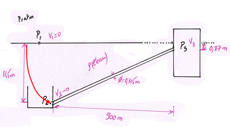

I must be missing something. Is there a flowpath between point 3 and point 1?? The sketch shows the pipe between P2 and P1

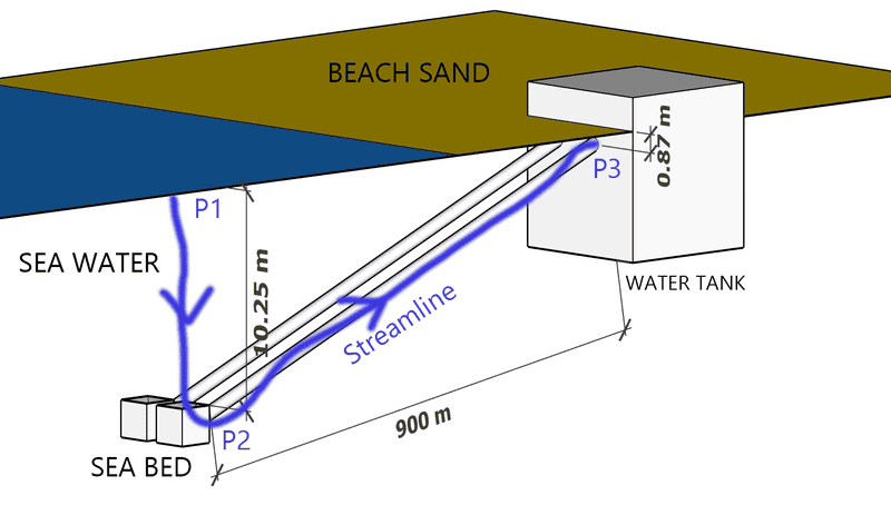

Seems odd, but this is a streamline.

I do not understand why P1 enters into the equations. The flow width between P1 and P2 is vast, meaning the flow rate is minuscule and head loss can be ignored.
Just consider the stream from P2 to P3.

It really doesn’t enter in, it’s just an efficient place along a streamline. P1 = 0 gauge, and the kinetic head at 1 is effectively 0. If we go directly from 2 to 3 you end up having to solve for P2 ( sure you could do this by inspection but why bother, it’s not pertinent info). It’s a waste of a step. Losses aren’t being considered between 1 and 2. The indices on the summation refer to portions of pipe.
Edit: I see what was confusing you( I think). I had my summation of losses going from 1 to 2 in post 15. My bad. I was thinking in a general sense( between any two points “1 and 2”) to explain it. I changed them to go from 1 to 3 to match the context of this problem.

Thanks @erobz I wasn't seeing it this way.

This is more what I was seeing. It doesn't really matter, though, since the elevation difference is still 0.87 m. EDIT: I mean the difference in the (pressure plus elevation head).
Well, ##V_2## is also zero. ##\frac{P_1}{\rho g}+z_1=\frac{P_2}{\rho g}+z_2##.

Usually we are taking 2 at the pipe entrance, and ##V_2## will not be zero. In going from (2) to (3) For a straight pipe ##V_2 = V_3##, and the kinetic head terms cancel on each side of the equation. We can throw a wrench into that by having the outlet a different diameter, they will not cancel and there will be an additional variable to contend with.
In going from (1) to (2) we still have ( with (3) as the elevation datum ##z_3 = 0##):
$$ \cancel{\frac{P_1}{\gamma}}^{0} + z_1 + \cancel{\frac{V_1^2}{2g}}^{\approx 0} =\frac{P_2}{\gamma}- z_2 + \frac{V_2^2}{2g} $$
$$ \implies \frac{P_2}{\gamma} = z_1 + z_2 - \frac{V_2^2}{2g}$$
Then going from (2) to (3):
$$ \frac{P_2}{\gamma}- z_2 + \cancel{\frac{V_2^2}{2g}}^{V_2 = V_3} = \cancel{\frac{P_3}{\gamma}}^{0}+ \cancel{z_3}^{0} + \cancel{\frac{V_3^2}{2g}}^{V_2 = V_3}$$
$$\implies \frac{P_2}{\gamma}- z_2 = 0 $$
Substituting for ##\frac{P_2}{\gamma}##, with ##V_2 = V_3##:
$$ \implies z_1 = \frac{V_2^2}{2g} = \frac{V_3^2}{2g} $$
For this reason going directly from (1) to (3) is the more efficient choice ( i.e. the solution is completed in a single application of Bernoulli's).

There may be some confusion re P2. I am taking it as a point a short distance in front of the pipe entrance, whereas you seem to mean a point within the pipe.
If I rename my P2 as P2a, the velocity is zero there and ##\frac{P_1}{\rho g}+z_1=\frac{P_{2a }}{\rho g}+z_2##.
Going from P2a to your P2 the velocity jumps to v and the pressure drops correspondingly. But we don't need to find the pressure there since we can compare P2a with P3.
But I agree there is no difference in effort between using P1 and using P2a. It's only a question of which view is conceptually more comfortable.

$$ \frac{P_1}{\rho g} + z_1 + \frac{V_1^2}{2g}+h_p = \frac{P_3}{\rho g} + z_3+ \frac{V_3^2}{2g}+h_t+ \sum_{1 \to 3}h_l \tag{Energy Equation}$$
Between points (1) and (3)
##h_p## is the pump head added
##h_t## is head extracted by a turbine
##h_l## head loss - viscous dissipation
The last term is typically broken up into two components. Major head loss - from pipes, and minor head loss from plumbing components, elbows, valves, couplings, etc..
$$ \sum_{1 \to 3}h_l = \sum_{pipes} h_l + \sum_{components}h_l$$
The sum over the pipes is represent by the Darcy-Weisbach Equation applied to each section of pipe:
$$ \sum_{pipes}h_l = \sum f_i\frac{L_i}{D_i} \frac{V_i^2}{2g} $$
##f## is the friction factor
##L## is the length of pipe
##D## is the pipe diameter
The sum of the components is usually represented by a factor ##k## that is found in tables for a particular component:
$$ \sum_{comp.}h_l =\sum k_i\frac{V_i^2}{2g} $$
The Energy Equation then becomes:
$$ \begin{aligned}\frac{P_1}{\rho g} + z_1 + \frac{V_1^2}{2g}+h_p =& \\ & \frac{P_3}{\rho g} + z_3 + \frac{V_3^2}{2g}+h_t+ \overbrace{ \sum f_i\frac{L_i}{D_i} \frac{V_i^2}{2g} }^{\text{pipes}}+ \overbrace{ \sum k_i\frac{V_i^2}{2g}}^{\text{components}} \end{aligned}$$
$$\text{(Energy Equation)}$$
Any questions so far?
Diagram of a seawater intake pipeline: sea water enters at P1 on the sea surface, runs down a vertical drop of 10.25 m to P2 at the sea bed, then along a 900 m inclined pipe to P3 at a water tank on the beach sand, with a blue streamline and the 0.87 m tank height marked.
This a more clear (I hope) Illustration
