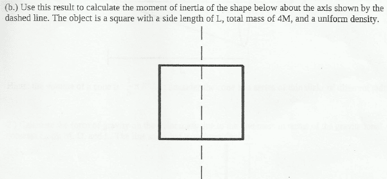

See below for the diagram.
Use this result to calculate the moment of inertia of the shape below about the axis shown by the dashed line. The object is a square with a side of length L, total mass of 4M, and a uniform density.

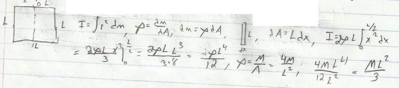

I got
I = (ML^2)/3
My work is attached below. The reason why I ask this question is because I can't find the answer any were online for moment of inertia of a square about this particular axis and just wanted to make sure that my answer was correct. Thanks for any help you can provide if it's wrong.

Your work is fine.
Wikipedia has a list of area moments of inertia.
http://en.wikipedia.org/wiki/List_of_area_moments_of_inertia
If you look at the first rectangular one, it's basically the result you want if you identify bh, the area of the rectangular, with the mass, and set h=L. Then you get
[tex]I = \frac{bh^3}{12} = \frac{4M L^2}{12} = \frac{1}{3}ML^2[/tex]

Ok the square is hollow and it's just a wire frame in the shape of a square and is why I got the problem wrong.
