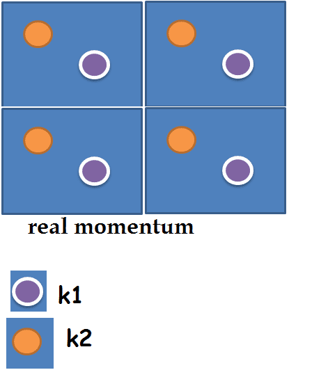

So, although each ##k## couples to many different values of momentum, it seems those values of momentum are not shared with others in the same B.Z. But you will not get the values of ##p##to overlap for two ##k## in the same BZ. I am trying to illustrate this idea with the following crude picture.
You would have to go out of the BZ to get another value of k that corresponded to the same p. Once outside the BZ you could add a reciprocal lattice vector.
$$p_0/\hbar = k_1 + \underbrace{0}_{G_1} = \underbrace{k_1 + \mathbf{b}_1}_{k_2} - \mathbf{b}_1 = k_2 + G_2 $$
So
$$k_2 =k_1 + \mathbf{b}_1$$ would also correspond to the same momentum ##p_0##. This was by using a different value of ##G##, ## G_2 = - \mathbf{b}_1 ##. But by adding ##b_1##, we left the BZ of ##k_1##.
