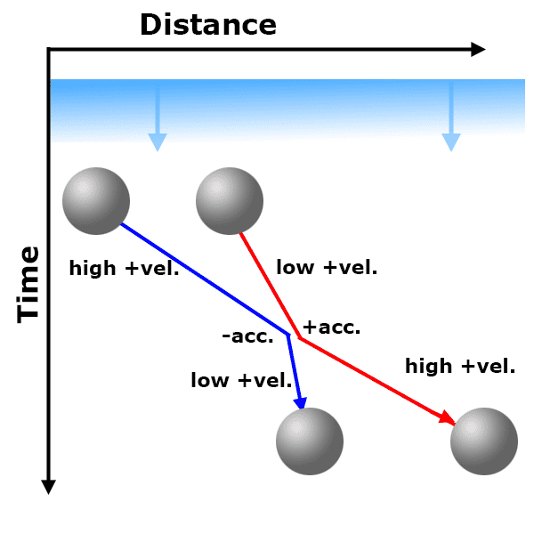

paulb203 said:
Thanks.
I think I get that. A leftward acceleration in this case would be a case of slowing down, of deceleration, I think; but if the first cart 'rebounds' does that mean it actually MOVES LEFTWARDS, initially, before resuming it's rightwards path? Or does it simply decelerate (accelerate leftwards, accelerate in the negative direction)?
It simply decelerates.

paulb203 said:
Thanks.
The second is correct. A negative acceleration can still result in a positive (though smaller) velocity.
Read this diagram as if time is a horizontal line, sweeping downwards (blue arrows):
