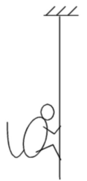

A monkey of mass m is climbing up the rope with uniform speed, the tension in the rope will be
F=ma
I think the tension in the rope will be equal to its weight , mg.
I want to ask what if the monkey accelerates up with acceleration a, then what will be the tension in the rope?

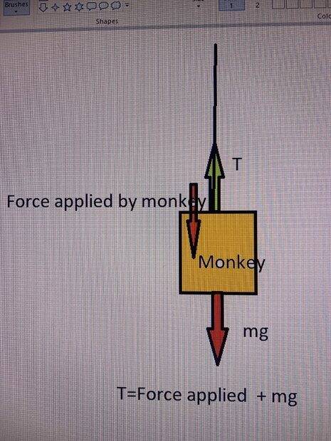

phinds said:
Can you draw a force diagram showing all the forces acting?

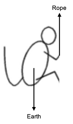

As you have been told several times, I believe, a FBD should show one system (often one rigid body) and all the forces acting on it; no internal forces. That diagram shows the gravity acting on the monkey and the monkey's force on the rope.
And I think this will increase the tension.
Are you saying monkeys force is internal?
Edit: Free body diagram alone doesn't give the answer. Force applied by monkey is to be considered.

You really need to start paying attention to @haruspex (and others).
A free-body diagram of the monkey should show only forces acting on the monkey. (Only two forces here.) Then you can apply Newton's 2nd law to those forces.
rudransh verma said:
Look at the beauty of my FBD. So pretty.
Yep. Too bad beauty doesn't count and it is functionally wrong. See post #11

Let me explain in more detail.
If the FBD is for the system "monkey", it should show all and only forces acting on the monkey, not forces the monkey exerts on anything else. You have shown the force the monkey exerts on the rope, when you should show the opposite force.
If the FBD is for the system "monkey+rope", it should show all and only forces acting on that system, not any forces internal to that system, so not forces between monkey and rope.

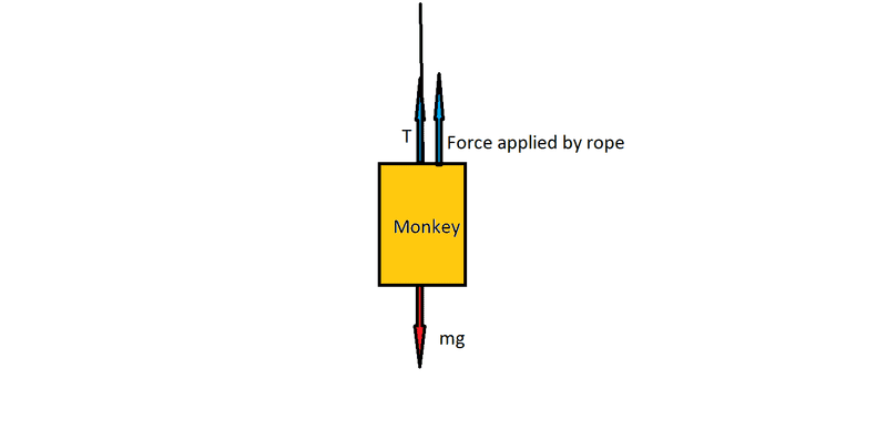

Oh yes you are absolutely right.
Much better, but now you have shown it twice, once as "force from rope" and once as T.
So what equation can you write from that?
##T=F_{RM}+mg## where ##F_{MR}## is force applied on monkey by rope.
Edit: @haruspex Is it right?
Realize that the force the rope exerts on the monkey is the tension in the rope. Don't count it twice. Only two forces act on the monkey.
No one has mentioned friction. I'd look at the system is like this:
- for the monkey climbing (or hanging onto) the rope, the only upwards force on the monkey is the upwards friction of the rope on the monkey, ##F_{rm}##;
- for the rope (assumed of negligible weight), the only downwards force on the rope is the downwards friction of the monkey on the rope ##F_{mr}##.
##F_{rm}## and ##F_{mr}## are a Newton’s 3rd law pair so have equal magnitudes.
With this view, the tension doesn’t directly act on the monkey, so it should not be shown on the monkey's FBD.
Similarly, the monkey’s weight doesn’t directly act on the rope, so it should not be shown on the rope's FBD.
What part of "but now you have shown it twice, once as 'force from rope' and once as T" did you not understand?

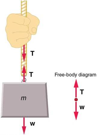

You say pair. Are you talking about T and ##F_MR## as pair?
Copied from
https://courses.lumenlearning.com/physics/chapter/4-5-normal-tension-and-other-examples-of-forces/
“A tension is a force along the length of a medium, especially a force carried by a flexible medium, such as a rope or cable. The word “tension” comes from a Latin word meaning “to stretch.” Not coincidentally, the flexible cords that carry muscle forces to other parts of the body are called tendons. Any flexible connector, such as a string, rope, chain, wire, or cable, can exert pulls only parallel to its length; thus, a force carried by a flexible connector is a tension with direction parallel to the connector. It is important to understand that tension is a pull in a connector. In contrast, consider the phrase: “You can’t push a rope.” The tension force pulls outward along the two ends of a rope. Consider a person holding a mass on a rope as shown...”
You say pair. Are you talking about T and FMR as pair?
No, that's not what I meant.

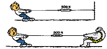

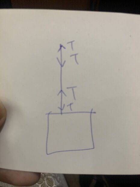

If a rope is under uniform tension T then you could consider any short section of it as a body in its own right and find that each end is subject to a force T acting away from it. So uniform tension is like equal and opposite pairs of forces acting all the way along its length.
If the tension is not uniform (e.g. massive rope hanging vertically) then the pairs are not quite equal.

In post#24 in diagram we can see T is upwards , downwards, acting on the rope , is the force that stretch the rope as you said. So all these are tension.
And in your post #21 you write ##T=F_{MR}##. Then in above post you write ##T=F_{MR}=-F_{RM}##.
Isn't this should be ##-T=-F_{MR}=F_{RM}## taking T as the force applied on rope(taking up as +ve)?
And we can also write ##T=-F_{MR}=F_{RM}## taking T as the force the rope applies.
