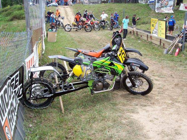

When the wheelbase is increased on a motorcycle for hill climbing, the rear axle is pushed rearward. The true effect is that the static weight is more on the front axle than the rear one, thus less chance of flipping over.
600_1946788.jpe

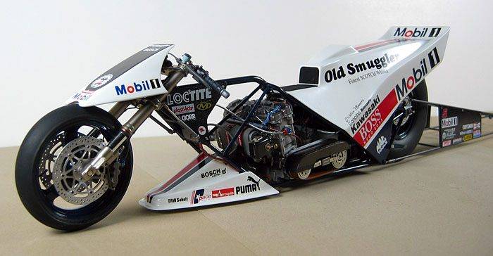

When the wheelbase is increased on a motorcycle for drag racing, the front axle is pushed forward. The true effect is that the static weight is more on the rear axle than the front one, thus more traction available for a RWD.
Just to show how wheelbase length is not that important, here is a picture of a funny car who's wheelbase was lengthen (by pushing the front axle forward) and another one who's wheelbase was shorten (by setting the rear axle closer to the CG). Both have the same objective: Put more weight on the rear axle.

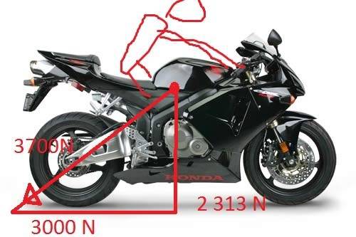

Yeah Torque as far as I know depends on the length of the leverage arm. Ok so how about I throw in what I think this would look like as an equation:

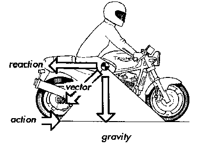

so here's a basic illustration I found online
I'm going to guess that when the resultant vector of all the forces on the COG is behind the contact patch you can get a wheelie.

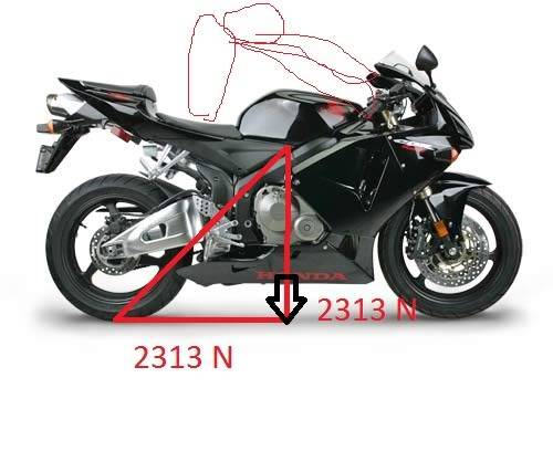

This is the maximum acceleration I think a motorcycle with this weight at that point can withstand continuously:
While this one will probably wheelie:
Does that math/reasoining work out?

I'll partially agree with you. But it still a ratio thing and the wheelbase has nothing to do with it.
In the end of it, here is the condition to make a wheelie (meaning vertical force on the front axle is zero):
Wd = Fh
Where W is the weight of the car, F is the traction force at the rear tires, h is the CG height and d is the horizontal distance between the CG and the rear axle. If this condition is met, it does not matter how long the wheelbase is. The horizontal distance between the CG and the front axle can be as long or as short as you want, it won't change a thing: the front axle will begin to lift.
So, it is not how long the wheelbase is that counts, but where the CG is with respect to the rear axle. And the important ratio is h/d; the bigger it will be, the easier it will be to do a wheelie.

That seems to go with the equation I gave in my previous post.
