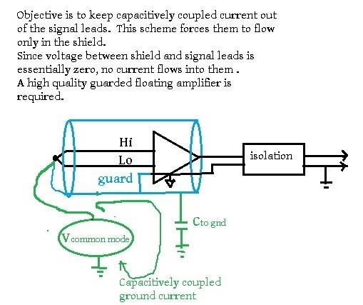

The school of thought i grew up on said "It makes no sense to ground a shield if the signal itself is not grounded. Enclose the whole measurement system in a Faraday cage connected to the low side of the signal at the point of measurement.".
Diagram of a guarded floating amplifier measurement scheme: a shielded cable carrying Hi and Lo signal leads into an amplifier with a guard connection, an isolation block on the output, and a capacitance to ground, with a common-mode voltage source and capacitively coupled ground current path shown in green.
This works exceedingly well when there's significant common mode voltage present.
Our plant computer used three pole relay multiplexers with floating guarded amplifier. It worked beautifully ,
  • Diagram of a guarded floating amplifier measurement scheme: a shielded cable carrying Hi and Lo signal leads into an amplifier with a guard connection, an isolation block on the output, and a capacitance to ground, with a common-mode voltage source and capacitively coupled ground current path shown in green.

I prefer shield tied to low side of signal and signal grounded only at point of measurement, per Morrison, and we wired the computer that way .
Our multiplexers used three pole relays to switch signal hi lo and shield to ADC's hi lo and guard lines.
ADC and its adjustable gain amplifier floated at common mode potential of each signal being measured, most of which were very near zero by our choice of where to tie into the individual current loops...
The relays were mercury wetted so had essentially infinite life. Indeed many of them clicked away once per second from 1972 to 2002 , accruing about 10^9 operations..
So our computer shielding was 'grounded' per that sketch i made which is what Morrison recommends in that book you ordered.
It really performed well reading thermocouples

My plant was consistent . All shields were grounded at the entrance to the instrumentation racks.
We had two instruments that used dual shields. I'll describe them.
One was the reactor neutron monitors. A couple dozen cables carried signals from neutron detectrs adjacent the reactor to the instrument racks in the control room, a couple hundred feet.
Both shields of each cable were connected to chassis at the back of the instrument rack where the triaxial connector plugged in. (Amphenol RF series, 53175 to best of my alleged memory)
The long long cables running out to the reactor ran in dedicated 4 inch steel conduits .
That conduit was mounted with insulated clamps all the way to the reactor and grounded only at the control room end, to the bottom of the instrument rack. So it made an effective third electrostatic shield and being steel provided considerable magnetic shielding as well.
The outer shield of the triaxial cable ended at the reactor.
The inner shield of the triaxial cable became the outer skin of the neutron detector.
The detectors themselves were mounted on ceramic insulators.
So we had Morrison's "Faraday Shield" surrounding the detector and measurement system, just it was grounded not way out at the point of measurement but instead at the entrance to the instrument. It worked well.

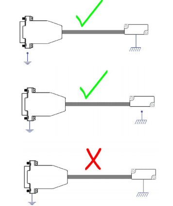

?518? "1) The twisted pair shield should be grounded at one end only. This ground shall be the instrument ground . It is critical that this shield be held to the instrument input reference ground potential. 2) The overall shield must be grounded at both ends, and at appropriate points along the cable. The rule of thumb is to ground at internal of 1/8 the wave length of the worst case expected radio frequency interfering noise. This may prove to be either impractical and/or undefined, thus the recommendation is to provide multiple grounds by grounding the outer shield at convenient locations where the shield(s) are exposed such as at pull boxes, junction boxes and termination cabinets. Failure to ground at both ends and, to a lesser extent at intermediate points, renders that outer shield useless and in some cases can cause interference/false operation. The outer shield is to be grounded to the safety ground not the instrument ground. 4) The use of metallic conduit, continuously welded metallic jacket, or covered trays is recommended as a means of providing additional grounded shielding. Note: The above shielding recommendations assume the use of instrument control/signal wire that is twisted pair, double shielded (each pair shielded with an overall cable shield). The shields shall be aluminum Mylar tape with complete coverage"my thinking on the outer shield grounded at both ends is, its better to run a cable in its own conduit than running it in open. the inner shield is only grounded where signal is grounded so that will protect the signal from circulating ground currents on the outer shield, the outer shield grounded at both ends will protect from other interference. i know mylar thin shield is not as good as rigid conduit but i think it works well for high frequency if grounded frequently. any thoughts on this?IEEE 1100 IEEE Recommended Practice for Powering and Grounding Electronic Equipment
i can't copy the text in my pdf
says grounding at one end does not protect signal from near field EMI, i believe they are talking about long runs of cable.
im trying to find IEEE 1143 IEEE Guide on Shielding Practice for Low Voltage Cables
and 518 (withdrawn(i think superseded by the above two))IEEE Guide for the Installation of Electrical Equipment to Minimize Electrical Noise Inputs to Controllers from External Sourceshttps://www.emcstandards.co.uk/cable-shield-grounded-at-one-end-only
https://www.celeramotion.com/sites/default/files/TN-1202_Grounding_and_Shielding_Recommendations.pdf
please remember i am talking about a cable that is shielded with two independent shields, inner is grounded where signal is, outer is grounded at every cable junction.
whats your thoughts on this? i appreciate anything even if your not sure.

There are times you have to choose how far short of theoretical perfection you are going to stop in order to accommodate the practical.
I have seen the results of welding current trying to return through a shield. (Somebody mentioned that earlier.)

Your Celeramotion folks seem to agree
Three diagrams of a D-sub connector cable shield connected to a device; top and middle show green checkmarks with the shield grounded at one end only, bottom shows a red cross with the shield grounded at both ends.
I never worked in a radio or radar installation so can't advise you there.
  • Three diagrams of a D-sub connector cable shield connected to a device; top and middle show green checkmarks with the shield grounded at one end only, bottom shows a red cross with the shield grounded at both ends.
did you see the part after that though? it recommends both ends but with capacitor, and i think those are for single shielded cable, but it doesn't say it either way so i don't know. page 3 figure 2 shows outer shield grounded at both ends and inner only grounded where signal is grounded
i should have also added that this is for an industrial environment with many motors, PWM drives, lighting, welding, radio(not a radio station but typical industrial radio communication) and possibly other noise sources I'm trying to think of. my thinking on leaving out some of these details was to try to avoid cluttering my posts and deterring comments.
thanks,

1100
-says best to ground both ends except sometimes with low frequency common mode dc signals. cable shields can carry unwanted ground current, use a blocking device except at one ground termination (silicon avalanche diodes or ac capacitor rather than rectifier diodes)
-long runs should have shield grounded at multiple points, or use SPD to ground everywhere but source
-electromagnetic shielding ground at both ends1143
-grounding both ends allows a counter current that cancels out interference
-when grounding both ends consideration should be given to the shield thickness, need shield thick enough for voltage gradients from faults, 0.19mm aluminum foil shield is usually thick enough
518
-it may be neccesary to ground the second overall shield at multiple points
-interesting side note, half of unused pairs and shields should be terminated at one end and the other half at the othermy summary
-grounding at one end provides electrostatic shielding, low frequency shielding.
-for grounding at both ends without an extra device you need shield of some thickness(probably 0.19mm for aluminum 0.15mm copper) and if its thick enough to withstand voltage gradients under a fault it is likely better to ground at both ends. the permeability of the shield is important for electromagnetic interference so thickness will play a role here as well. normal thin aluminum shields probably won't do much for electromagnetic shielding.
-grounding the shield at both points will still retain the electrostatic shielding ability
-don't leave shield floating it will enhance electrostatic field coupling
