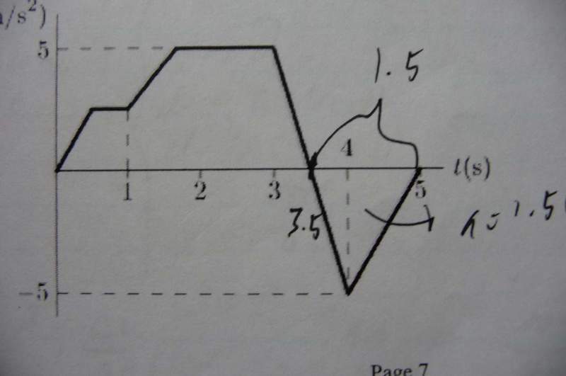

4. The acceleration of an object, starting from rest, is shown in the graph below. Other than at t = 0, when is the velocity of the object equal to zero? (see attachment, disregard writing)
a) during the interval from 1.0 s to 3.0 s
b) at t =3.5 s
c) at t =4.0 s
d) at t=5.0 s
e) at no other time less than or equal to 5 s
answer: E

4. Wouldn't the velocity be zero in the interval from 3-4 since the triangles cancel each other out?
No. Just because the acceleration is zero in that interval doesn't mean that the velocity is zero.
