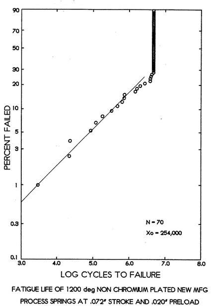

It sounds like your approach involves assuming a standard deviation in a normal distribution for the distribution of failure lives. Standard deviations are quite small for carefully prepared tensile fatigue specimens, but are much larger for more complex parts. Spokes have stress concentrations at the beginning of the threads, and at the bend. Spokes have residual stresses from the manufacturing process. The fatigue life is also affected by the pretension. And obviously by how the bike is ridden.
I once did a series of fatigue tests on bicycle spokes, but unfortunately the results have disappeared over the years. I also did a series of fatigue tests on a particular compression spring. When fatigue test results have a large variation in cycles to failure, and especially when interested in early failures, the data is well represented in the form of a probability plot. Below is an example of such a plot:
These spring tests were well represented by a three parameter Weibull distribution. This particular test had the Xo Weibull parameter equal to 254,000 cycles.
