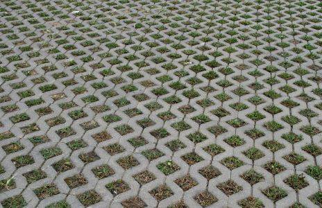

My mom and dad have a muddy driveway and every time I go over there it looks like their vehicles are getting deeper in the mud. He puts gravel in there every year, but that part of town the ground is just so soggy that it's not helping much. So we'd really like some suggestions on how to deal with that short of actually hot-topping the drive. Any ideas?
I'm not sure these would work if the ground is very soft. Also not sure of the cost. But I suppose you could just put them on the tire tracks, to keep the cost low.
That's interesting. I'll show them the pic and see what they think. Thanks.
