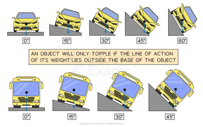

Also, even if the weight is evenly distributed when perfectly straight, if the floor is crooked and the stand is leaning, there will be a weight transfer from one side to the other. The following image is an example of the principle with a vehicle. The higher the TV's center of gravity and the narrower the stand base, the greater the weight transfer.
