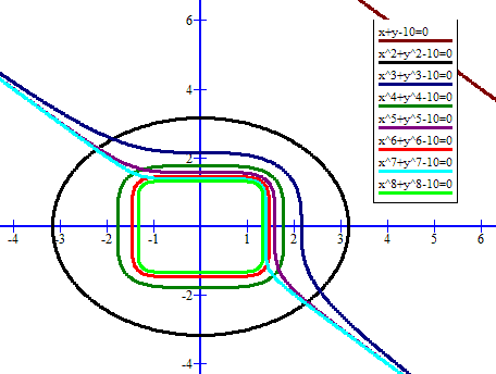

There is still the difference between odd and even powers:
I never heard about this concept before, so I don't think there are specific names for it. However, you're right, shouldn't be that complicated to figure out the formulas. The metric is probably the most challenging aspect here.

I haven't used a metric. Those are simply the solutions of your equation for a couple of ##n##. The metric only comes into play when you define the sine and cosine by the ratio of lengths. But as all metrics are basically the same, I don't expect much of a difference to the 2-norm.
Ok, the curves that you have plotted are fine, but let's examine the diff. equation:
