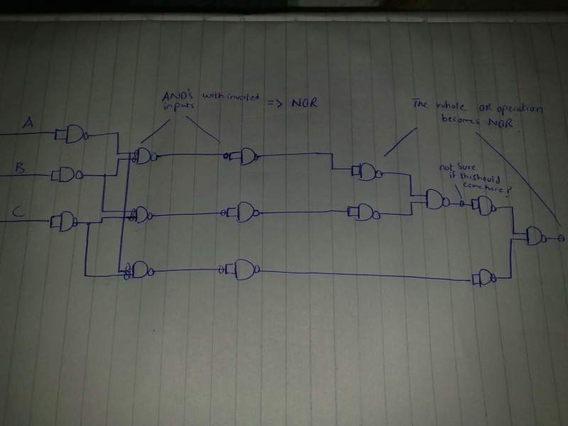

Okay what I originally did was that I assumed the AND's which we got from NAND gates and inverted their inputs as NOR=AND with inverted inputs and just inverted the OR gates formed with the NAND gates so that they become NOR so i guess that was wrong
Do I have to put invertors(bubbles) infront of the inputs and outputs of both the NAND's which were used to form the AND gate?

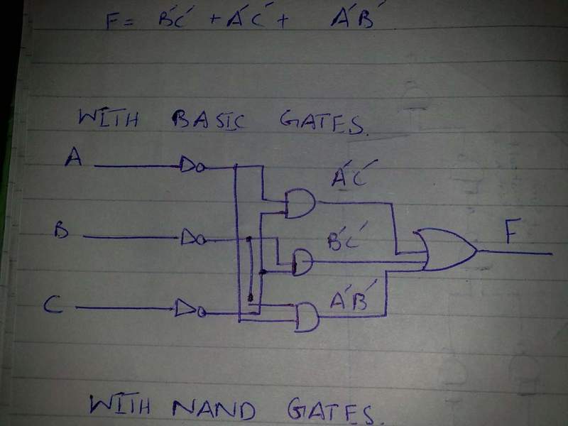

You can see the orginal schemtic which I did
  • Handwritten logic circuit on lined paper with inputs A, B and C feeding a network of NAND-symbol gates, with annotations reading ANDs with inverted inputs => NOR and The whole OR operation becomes NOR.
  • Hand-drawn logic circuit for F = B'C' + A'C' + A'B' built with basic gates: inputs A, B, C each pass through an inverter, feeding three AND gates and an OR gate that outputs F. Heading reads WITH BASIC GATES; a second heading below reads WITH NAND GATES.

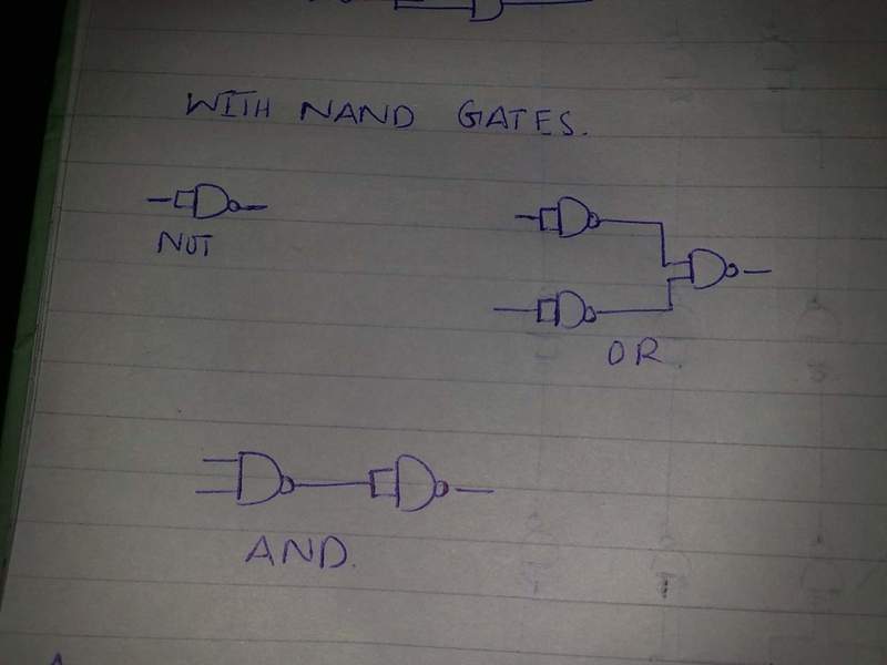

  • Handwritten notes titled 'WITH NAND GATES' showing NOT, OR and AND gates built from NAND gate symbols, with the OR and AND labels written below their circuits.

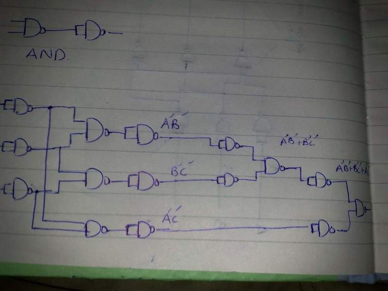

the last one
  • Handwritten logic circuit diagram built from NAND gates, with three inputs fanning out into three two-input gates labelled A'B', B'C' and A'C', whose outputs combine through further gates into a final output labelled A'B'+B'C'+A'C'.

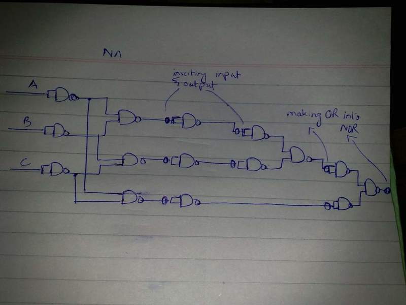

Here's what I tried what you suggested
  • Handwritten logic circuit on lined paper with inputs A, B and C built from NAND gates, with inverting input and output bubbles labelled and a final NOR gate at the right; annotations read 'making OR into NOR'.

I think you need to revise your understanding of a couple of things:
The 'bubbles' that are part of the symbols for NAND and NOR gates are just part of the symbols for the respective components - you can't "draw them in" on inputs (otherwise you are specifying a different component which you haven't got access to and may not even be manufactured). If you want to invert a signal, you use an invertor, also called a NOT gate.
NOT gates can be implemented by joining the inputs of either a NAND gate or a NOR gate, but you cannot implement a NOT gate with an AND or OR (or XOR) gate - look at the truth tables to understand why.
This means that you can construct ANY logic circuit using only NAND gates, or only NOR gates, but not using only AND, OR or XOR gates.
Your circuit with the NAND gates has two NAND gates connected in series, each with their inputs joined. What is the output from this section of circuit when the input is 1? And when the input is 0?
If you want to build this circuit with NOR gates you might like to start with the fact that A'B' = (A + B)' and so can be implemented with a single NOR gate, although you will get to the same result by replacing the NANDs with 4 NORs and eliminating the series inverters.

Well (i) I don't have any easy means of posting a sketch at the moment and (ii) I'm not going to do it for you anyway, you need to do it yourself. But I will help.
First of all there are 6 redundant gates in this circuit - eliminate them.
Then replace every NAND gate with a NOR gate with each input and output connected through an inverter - or if you like, draw bubbles on each input and output (the output will therefore have two bubbles). Now you can simplify this circuit: wherever a bubble on an output connects to a bubble on an input, elminate them both. Note that you can only do this with the extra bubble on the outputs because one bubble is part of the circuitry of the NOR gate. Also where an inverter connects to a bubble, or a bubble to an inverter, eliminate them both.
Your answer should have a total of 7 NOR gates, 2 of them wired as inverters. The effecient solution with NAND gates had a total of 9, 4 of them wired as inverters.
