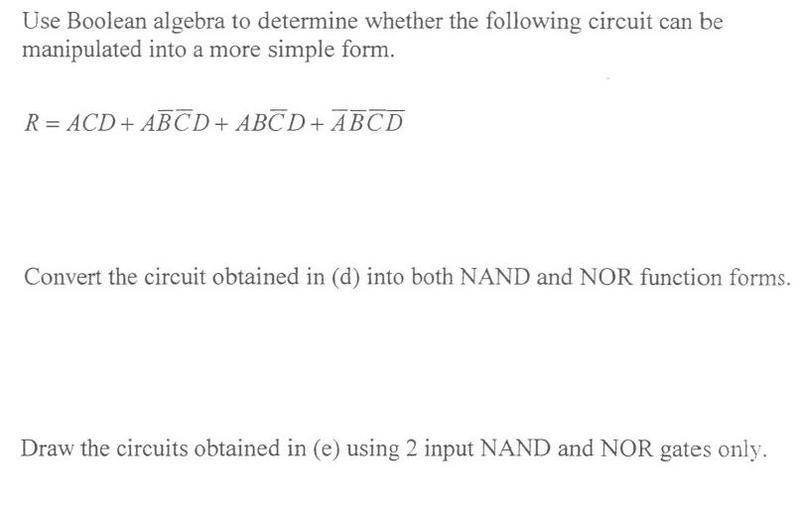

Please see the attatched picture.
I can complete the first part of the question, but i am not sure how i should do the second part.
I would be grateful for a quick explanation or tutorial in how to do this part. I am aware of de Morgan's laws but can't seem to fully apply them to convert a whole circuit.
Im not looking for an explicit answer, I am looking for a technique in how to solve the problem.
Thanks.

Tell us what deMorgan's Laws are, and include an example or two.
Then please show us the solution that you got for the first part, and describe how you would implement it as written with NOT, AND and OR gates.
Then we can talk about how to use deMorgan's Laws to convert to the other form of the circuit...

For the first part i got:
CD + Not(A+B+C+D)
To get this i combined some of the expressions, then finally used demorgan's law as stated above.

I guess I was looking for the implementation in gates, for the final part of the problem.
We would have 4 input A B C D.
We have a connection from both C and D to an AND gate (which is the CD part)
We also have a connection from all A B C D to a NOR gate. (which is the NOT A+B+C+D part)
Output from these two gates are then connected to an OR gate.
Remember, it said 2-input NAND and NOR gates, so you can't use a 4-input NOR for (A+B+C+D)
In that case i think it would be possible to, applying de Morgan's laws, split up this 4 input NOR gate into two, 2 input NOR gates AND 'ed together.
NOT (A + B) . NOT (C + D)
The output of this would be equal to the 4 input NOR gate.
Regards.
That's pretty cool. I was thinking of the brute force way of using the 2-input NAND as an inverter (hook both inputs together), but your way is more creative and fewer gate delays.
