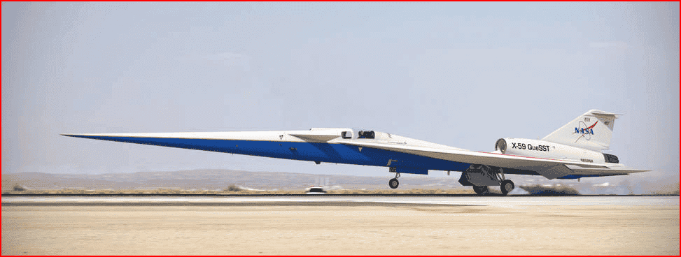

NASA's X-59 quiet supersonic aircraft and future of civilian supersonic flight
30 replies · 8K views
37,546
14,425
TL;DR
The final approval to build the X-59 QueSST has been given. It will be reviewed in late 2020 for a flight in 2021.
Press release
The Concorde could only fly supersonic while over the open ocean - the sonic boom was too loud. NASA is looking for aircraft designs that are much quieter. While the X-59 itself isn't very practical for passenger transport it might have some direct military applications and help design passenger-friendly aircraft in the future.
What do you think - is there still a market for civilian supersonic aircraft? They are faster, but they are more expensive and offer less comfort than subsonic aircraft.

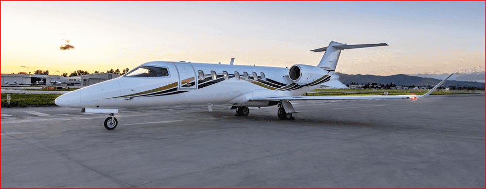

It seems like one of the initial applications for this technology would be in an SST version of the Executive LearJets. They already look pretty similar... :wink:
https://www.nasa.gov/press-release/...-research-aircraft-cleared-for-final-assembly
https://www.claylacy.com/wp-content/uploads/2019/02/Learjet-70-847-Ext.jpg
