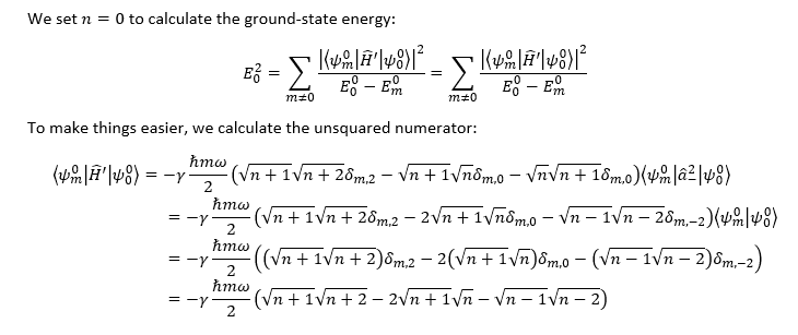

Calculate the second-order correction to the ground-state energy of the stationary states of the system.
The perturbed Hamiltonian is:
H' =- (/gamma /hbar m /omega)/2 (a+ - a-) ^2
2 & 3. Relevant equatio and the attempt at a solution
This is not right. I follow the same procedure as letting the ladder operators act on eigenvalues, i.e. that a+|n> becomes (√(n+1))|n+1>
Did you have a question?
I didn't notice at first that my post is lacking some details.
My question is this: Where in my calculations did I make a mistake in calculating a solution to the problem?
Why do you have factors of "n" all over the place? There should be only an "m" and in each term is has a specific value (like m=2!) so you should get numbers for all the matrix elements (and most of them are zero)
How do I figure out which value of m each matrix element should have?
I figured it out.
I got the following result: sqrt(1)sqrt(2).
(Which is correct)
