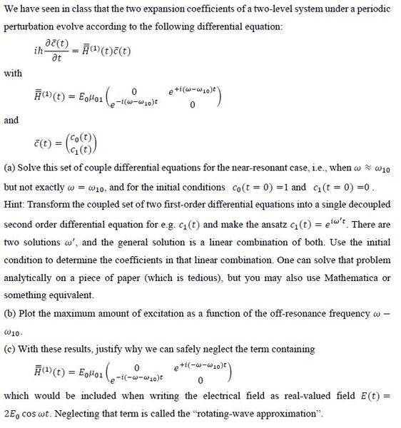

Hello, I have the following task:
[/B]
In the task[/B]
I looked at this task with the notes from the class, but I can't really see through. It seems that the first step is the transformation into the single decoupled second order differential equation, but I don't actually understand how to do that and at which point I need a program to solve it. Can someone guide me through the solution process?
[/B]
Write the two equations for ##\dot{c}_0## and ##\dot{c}_1## and derive both sides with respect to time. It shouldn't be too hard to see then how to obtain the two uncoupled equations.
Hello,
thank you for helping me.
I tried to do that and obtained the following:
If this is correct, I still don't see what I have to do in the next step and when I have to use a program.
