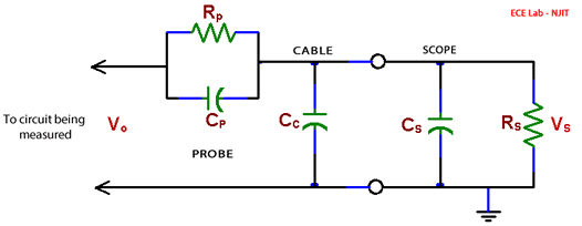

In terms of bandwidth, you can use the trick used in oscilloscope probes to get good BW even through a voltage divider:
(Cp is the variable capacitance in this case)
http://ecelabs.njit.edu/ece291/lab7.php

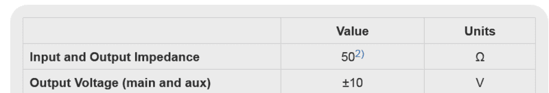

There are several input & output specs :
Max Input Voltage DC Level ±500 mV
Max Input Voltage Signal Amplitude ±500 mV
Ramp Amplitude (Max)
±5
V
Output Voltage (main and Aux)
±10 V
RF Output Max Amplitude (-PL only) ±75 mV
RF Output Impedance (-PL only) 50 Ω
Error Input (BNC)
datasheet inputs:
This is the input for the error signal. In SIDE LOCK mode, the signal is amplified by 26 dB and summed with the DC OFFSET and DC OFFSET INPUT (back panel). In PEAK LOCK mode, the ERROR INPUT is demodulated by the dither frequency and is then amplified by 26 dB and summed with the DC OFFSET and DC OFFSET INPUT (back panel). In both modes, the amplified signal can be seen with the DC ERROR MONITOR and the AC ERROR MONITOR.
Gain Sign (two-position switch)
The lock switch has three positions. The lowest is the RAMP, which connects the internal ramp to the SERVO OUTPUT causing the laser to sweep. The amplitude of the sweep is controlled with RAMP AMP knob. In the center position (UNLOCK) the ramp is disconnected and zero volts is output to SERVO OUTPUT. In the top position (LOCK) the loop filter is engaged.

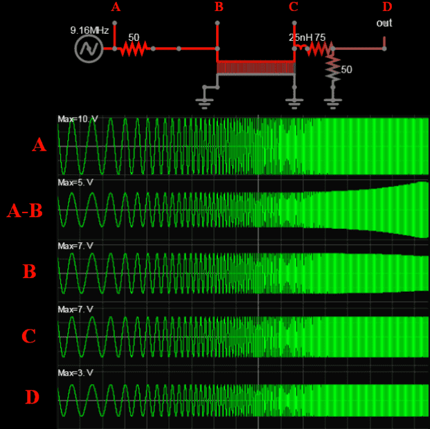

Just thinking on the back of an envelope.
For an RF coaxial 50 ohm attenuator;
10 volts / 50 ohms = 200 mA input.
6 volts; 1.2 watts in the attenuator.
4 volts; 0.8 watts in the load.
Maybe a simple series resistor of 75 ohms could drop the extra 6 volts.
10 volts / (75 + 50 ) ohms = 80 mA.
4 volts; 0.46 watt in the 75 ohm resistor.

You have been given good advice. it is not hard to make a small series R attenuator for 10 MHz Bandwidth can tolerate a few cm of inductance from the lead lengthSince 10V is the maximum with 0.46W we would expect a 0.5W to rise 100'C and a 1W resistor to rise 50'C which is OK for the resistor but might burn a finger and a 5W resistor would only rise 10'C which is cool to the touch.
But then the amount of time your error signal is 10Vdc is going to be small and this reduces to some small value when it is locked. So the choice of power rated series 75 Ohm resistor which will attenuate fine 50/(50+75)=40% of input. Anything from 0.5W to 5W will work fine.
Perhaps you can salvage a short BNC cable and splice the series resistor in series. The microwave worthy parts are overpriced because of the radius ratio tolerances which define the impedance errors and return loss.How you create this is a simple mechanical problem. To solder the resistor between BNC female jacks or how perform this simple task is up to your imagination. A BNC splitter or attenuator might be convenient but $$. You can order attenuators from Pasternack, to avoid this. But that is $65 overkill for a << $1 resistor and connectors. I would just splice a cable and insert the 75 Ohm 0.5W to 1W resistor and coat with epoxy or PU for strength.

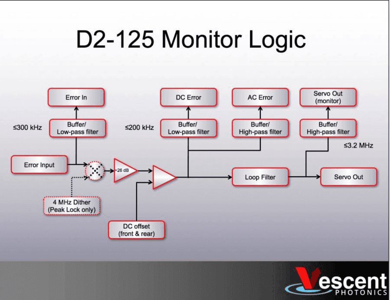

Umm... are you sure? I thought it was the freq. input to the laser; what we, in the controls world, would call the plant input, after the error amp and compensation. I think you have to plan on the loop locking near and staying near 10V. IDK, maybe the rest of the system parameters (which we don't know) make this unlikely.
You're right, I'm not sure of the block diagram for this application. But we design for worst case anyways.
snip from datasheet
The SERVO OUTPUT is the output from the loop filter when in LOCK mode, zero volts when in UNLOCK mode, and a DC balanced triangle wave when in RAMP mode. The ramp can be shifted with respect to 0V using the ramp centering functionality.Auxiliary Servo OutputThe AUXILIARY SERVO OUTPUT is generated from integrating the SERVO OUTPUT. Its purpose is to supply a correction signal to drive the SERVO OUTPUT to zero. When used with Vescent DBR lasers and the D2-105 Laser Controller, the AUXILIARY SERVO OUTPUT can be connected to the TEMP SERVO IN to adjust the laser diode temperature to keep the feedback laser current constant. Similarly, AUXILIARY SERVO OUTPUT can drive a PZT on an external-cavity laser diode to keep the laser diode current constant"

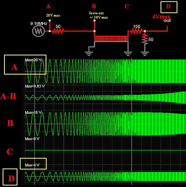

Kelly would leave less uncertainty and guessing if a proper block diagram and all pertinent specs were provided in the initial question.
Please confirm the following uncertainties.
1. Is the laser input = 50 Ohms ?
2. If +/-10V out is with 50 ohm load then unloaded is +/-20V
If 1&2. are true then you need a 150 ohm series metal film 2W resistor to a 50 Ohm load.
If 2 is false, then you need a 25 ohm series resistor 2W to the 50 ohm load laser.
If 1&2 are false then you need 2 resistors.
