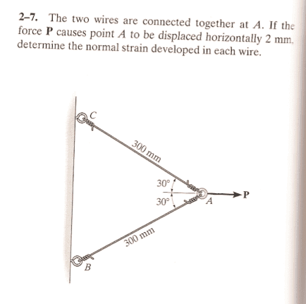

So in this problem, all I have to do is to solve it is find out by how much cables AC and AB elongate.
I thought I could just break it into two Right triangles and just use similar triangles (before and after elongation)
If you look at the upper right triangle, let's call it ACO, where O denotes the point on the wall halfway between C and B.
Then I tried doing,
[tex]\frac{AC}{OA}=\frac{AC'}{OA'}[/tex]
[tex]\Rightarrow AC'=\frac{300}{300\cos30}*(300\cos30+2)[/tex]
But this does not work. . . why the hell not??
My prof gave us the hint: "Use Law of Cosines to find the lengths of AC or AB after elongation"
How do I use Law of Cos if I don't know the angles after elongation, and moreover what is wrong with the process I tried?

Mechanics of Materials eh?
http://www.mediafire.com/?0fmwmgeogi6
Where did you get that? Anyway, thanks! I think the dotted line should be labeled [itex]L_{AC}'[/itex] though. But now I see it. I never took a geometry course so this stuff makes me insane.
Do you know why my original method does not work?
because they won't be similar triangles...

ummm. . . because the angle changes right?
