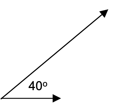

Ok. My problem is what angle to choose when adding vector. Statement does not tell me which one is the "first" force vector. So, when using the law of sine formula I get two results.
First, using cosine to get the magnitude:
$$\vec c = \sqrt{a^2 + b^2 +2ab\cos\theta},$$
$$\vec c = \sqrt{15^2 + 35^2 +2(15(35) \cdot \cos(40)},$$
$$\vec c = 47~\text{lbs}$$
NOW; how and what angle do I choose for the resultant? (I know the problem is not asking for it but I want to practice). Picture of it attached.

The angle between two vectors is always the smaller angle that you get when you draw the arrows representing them with their tails together (see diagram drawn to scale.) It is less than or equal to 180°.

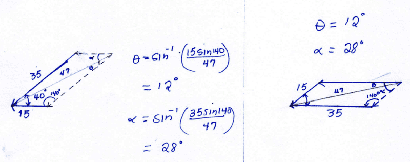

@kuruman @PeroK
Yeah, sorry for not showing work. Here it is:
If ##\text{vector-15}## is along the ##x\text{-axis}##, then:
$$\theta = \sin^{-1} {(\frac {15 \sin{140}} {47})}$$
$$\theta = \text{28°}$$
If ##\text{vector-35}## is along the ##x\text{-axis}##, then:
$$\theta = \sin^{-1} {(\frac {35 \sin{140}} {47})}$$
$$\theta = \text{12°}$$
And 28 + 12 = 40, which is the angle between the original vectors. So, the resultant vector is 12 degrees from the longer vector and 28 degrees from the shorter vector.
Note that ##\frac{28}{12} = \frac{35}{15}##.
