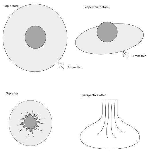

As a fun project, I'm trying to design a mechanical machine as simple and elegant as possible to "crease up" a round flat piece of dough around a meatball.
Any suggestions how this could work? If you know a better place where I should ask for help, please tell me.
P.S. You will notice that in the "Top after" image the dough has not come all the way together, I in fact would like it to come together and close.
I've attached an image

First thing that I envision is something like the disappearing handkerchief magic trick -- place it over hole, push down on the center, causing the dough to fold up, then crimp it closed, perhaps with something resembling a camera lens iris.

The only stumbling block that I can think of is ensuring that the meatball actually depresses the dough into the mould cavity rather than just poke a hole through it. Maybe a vacuum port in the bottom of the mould to suck the dough in first... naw, that wouldn't be any better. Hmmm... Rats! I really like the elegance of your solution, but I'm just not sure that the dough would have enough structural integrity to withstand the process. Again, hmmm... a substrate that supports the dough as it's being moulded? I'll keep thinking on it.
Meanwhile, another possible approach is to join two pre-moulded half shells with the meatball in the centre (sort of like a Tootsie-Pop). That presents its own difficulties, of course.

the picture looks more like a shaomai - steamed, half-closed dumpling in a round shape usually eaten for dimsum. Dumplings are more a oval shape.
hm, making a machine to do this might be difficult... what you could do is to put the meatball on a stick, and then drape a flexible pastry on top of it - like a tablecloth, and then crimp the bottom of the pastry, before turning the whole thing the right way round and removing the stick...? if that is understandable at all...

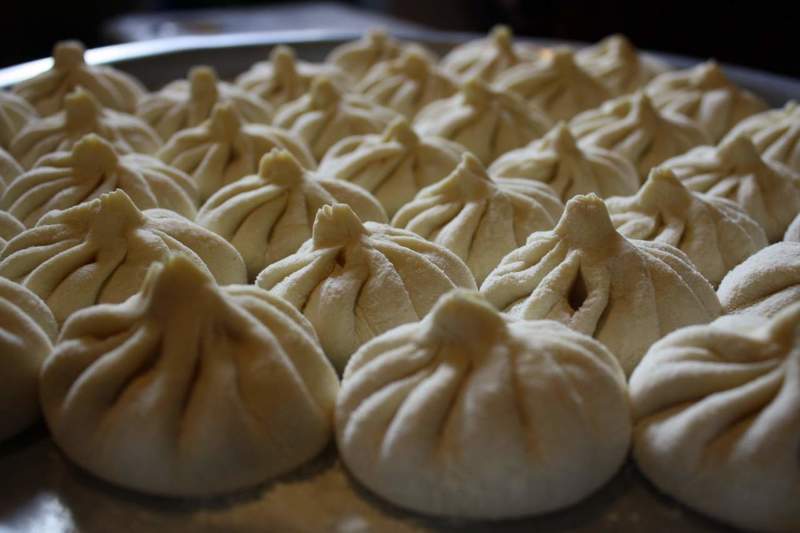

Thanks everyone for good ideas and trying to help. I'm attaching a picture of what the end product should look like, please note that the end product in the picture is hand rolled.
Okay, then. If that's exactly what you want them to look like, I think that your best bet would be to pre-mould the pockets, drop in the meatball, and then use a multi-point gripper to crimp the top. Pantaz's idea of an iris diaphragm for that purpose would have the advantage of automatically imparting that little twist. (At least, I believe so based upon watching irises in operation. The innermost points of the leaves seem to move laterally a bit as they close.)

I just watched the video. I was afraid of that. The top is not crimped in one step (like closing a garbage bag). I think that sequential crimping will turn out to be critical - a step you cannot get around.
Doing it in multiple steps ensures that the individual crimps are all even. If you did it in one step, you'd get some creases much larger and longer than others - not out of sloppiness, but because you can't force the even distribution of the folding.
Try doing this with a piece of paper (which doesn't stretch well) and you'll see the problem. Paper just will not behave this way - and neither will the dough unless you do the steps discretely, allowing the dough to stretch just a small bit with each crease.
