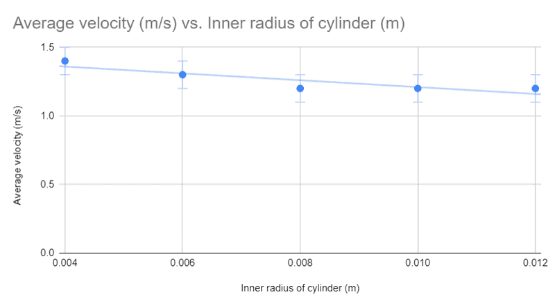

I had to find whether the inner radius of a cylinder affects its velocity when it rolls down an inclined plane. I timed each trial and I found there was a negative correlation. The formula I provided is a derived equation. I found the velocity for each inner radii value based on this formula, and now I have to find the uncertainty

So you have pairs of velocities and inner radii at fixed ##h## and ##r_o##? If so, did you make a plot of velocity vs. inner radius? You must have otherwise you wouldn't know that there is "a negative correlation." For each of the measurements of ##v## you can use the formula to calculate a maximum and minimum value given your estimated uncertainty in ##r_i## and draw error bars on the graph. Then you can add a continuous theoretical solid line using the formula and see how close it comes to your measured values.

what do you mean by a "continuous theoretical solid line using the formula"? As in a line of best fit?
this is the graph I currently have, which displays my experimental values with an uncertainty of plus/minus 0.1 m/s.
Sorry, I do not understand what you mean.
This is what I mean.
You have the equation $$v=\sqrt{\frac{gh}{\frac{1}{2}+\frac{ r_o^2+r_i^2}{r_o^2} }}$$
You also have values for ##h##, ##g## and ##r_o##. Put them in the equation.
Use the equation in a spreadsheet (or something like it) to calculate ##v## for 30-40 values of ##\cancel{r_o}~r_i## between 0.004 m and 0.012 m.
Connect the dots with a straight line.
The line so obtained is your theoretical prediction on which the velocity data points that you measured should lie within experimental error.

You now seem to be saying that your case is this: you have multiple sets of inputs and outputs in which the output and one input vary, you possibly have a priori estimates for the error in each, and you want an estimate for the error in the slope relating the variable input to the output.
That does seem strange because it means your equation is really $$v=k\sqrt{\frac{gh}{\frac{1}{2}+\frac{ r_o^2+r_i^2}{r_o^2} }}$$
and you want to find k and assess the error in that value. That is strange because you know k=1. So now I don’t know what you are trying to do, but if that is right, read on:
With no a priori estimates for the input or output errors, you can use https://saturncloud.io/blog/how-to-calculate-slope-and-intercept-error-of-linear-regression/.
If you have a priori estimates for the input and output errors you should in principle be able to do better, but I have never found a general method that handles that.
At a guess, your greatest source of experimental error is in measuring the velocity.

From your relevant equation (was it given or did you deduce it? -- how?) I gather you mean the instantaneous velocty at the bottom end of the ramp.
I would be surprised if your experiment involved drilling ever bigger holes in one single cylinder, so 'the outer radius stayed constant' might be an euphemism for 'we assumed ##r_o## was constant and didn't bother to measure it more than once' (and yes, I remember being told something similar, a long time ago :smile:)
We need to know a little bit more about how you conducted your experiment. How you kept constants constant and what exactly you measured.
Then there are two schools of thought for the analysis phase: only plot direct observations, or manipulate until you can expect a linear relationship. Often you do both (in particular the first during measurements and the second afterwards)
Your plot in #18 might be in the first category if there really were speedometers. But then you don't want to fit to a straight line. What you can see from the graph is that 0.1 m/s is probably too pessimistic for the error in ##v##.
A straight line would be expected in a plot of ##1/v^2## as a function of ##r_i^2## (can you see why?).
