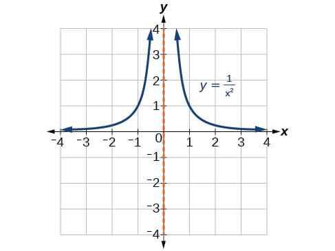

If i were to graph both of those as E-potential vs y distance.
Wouldn't it just be a 1/r graph on the positive side with it being a nonuniform rod? --Correct?

But my question was if i were to graph both of those as E-potential vs y distance.
I mean the rod itself was lamda equaling to alpha |x|.
It would look similar to a 1/y, but not exactly. The potential depends on the physical distance the charge is away. At large values of y, the charge is almost all focused on a point. At small values of y, this charge's distance varies.
It will look like a |1/y| graph in the sense that when y→0 V→∞ when y→∞ V→0 and it has no turning point etc

Ah I see. Just making sure, something like this?
yes, but not as extreme as 1/y2

Ah okay thanks! -- only wanted to make sure that we had to include one coming down on the negative side of the graph, but I guess that makes sense because the (q) density is alpha|x|.
Yes, it clearly has to be an even function by symmetry
