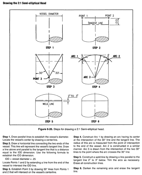

Hi,
I am looking for a formula to have the volume of this shape.
Here is how we draw it:
Thank you for your help :)
This is a 'volume of revolution' problem . Look it up .
There is a graphical method as well . Also some CAD systems can work this out for you .
