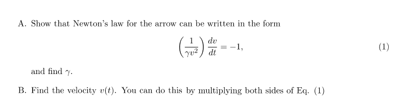

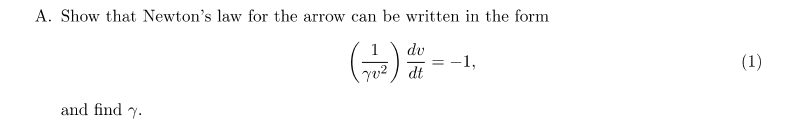

Show That Newton's law for the arrow can be writteb in the form
F=ma
I don't understand what the gamma letter in the equation is supposed to represent.
What do you get when you multiply both sides of the equation with ##-\gamma v^2##? Can you interpret what it says?
1=-gamma v^2?
I also need to find gamma, So I need to realize what the letter supposed to represent
I looked at the formula sheet and didn't find it there
Some1WhoNeedsHelp said:
1=-gamma v^2?
Nope. You get $$\frac{dv}{dt}=-\gamma~v^2.$$If I tell you that ##\gamma## is just a positive constant, can you interpret what this equation is saying to you regarding the motion of the arrow?

Nope. What you wrote down is the position of an object as a function of time under constant acceleration. Is the acceleration constant in this case? As a matter of fact look at the equation. Can you figure out an expression for the acceleration? Hint: How is the acceleration defined in terms of the velocity?
a = dv/dt
acceleration is meter/(seconds)2
and v2 is (meter)2/(seconds)2
So gamma must be meter
and using Newton's law
ma=(Cd*ρ*A*V2)/2
and since a = dv/dt
Gamma=-(Cd*ρ*A)/2mIs that correct?
Gamma is a positive constant. The motion of the arrow is opposed by air resistance (it's like friction). So in the equation ##\dfrac{dv}{dt}=-\gamma~v^2##, the left-hand side is a negative number because the speed ##v## decreases with time. Can you answer the questions posed by the problem?

The force is in the same direction as the acceleration and both of them are opposite to the direction of motion. The constant γ is positive. You don't need the absolute value if you handle the signs correctly.

No, it is not correct because it is self contradictory.
The magnitude |F| of the drag force is positive and one can write
|F|=(Cd*ρ*A*V2)/2=mγV2.
If one wants to write Newton's second law, one must write
F= m dv/dt = -(Cd*ρ*A*V2)/2 = -mγV2.

Time is not negative. You forgot the limits of integration. Assume that at ##t=0## the arrow has velocity ##v_0## and some later time ##t## it has some other velocity ##v##. Set the limits of integration, then integrate.

I have no idea how you get that result from the integration. What is the integral (1/x2).dx?
Try again, taking one small step at a time so that we can see where your error is.

That looks better.
But please use parentheses appropriately. What you have written means (1/γ)v, where you mean 1/(γv). And it would have been more natural to have set the bounds the other way up, ##\int_{v_0}^v, \int_0^t##.

No, it asks you to find the value of t.

Alright so according to the equation I created from post #21
-1/(γvt)+1/(γv0)=t
-v0+vt=-γvtv0t
vt+γvtv0t=v0
vt(1+γv0t)=v0
vt=v0/(1+γv0t)
So as time keeps increasing the vt will decrease to the point the speed of the arrow will become neglectable, so the arrow will stop
