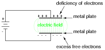

So I'm reading that in a capacitor, an electric field is being manifested between two plates. There are no electrons actually traveling from the negative to the positive plate, correct? There is only an attraction?
Also, I understand that electrons are being gathered on the bottom plate (connected to the negative terminal), but could someone explain what is occurring to the top plate connected to the positive terminal?
The simple view is the electrons depart from the top plate, pass through the battery, and arrive at the bottom plate. Thus the battery itself neither gains nor loses electrons. Its function is to provide the force that moves the electrons. The battery is analagous to a water pump - it makes the water move, but is neither a source, nor a sink, for water.

Yes, that's correct. Not through the dielectric medium anyway.
But there's something strange going on here, because despite the lack of flow of charge (i.e. conduction current) between the plates, the magnetic field (as per Ampere's Law) that you typically associate with an electrical current is still present between the two plates when it charges! In fact, the magnetic field between the plates indicate that the current between the plates is equal in magnitude as that of the conduction current in the connecting wires. It turns out there are two kinds of current, and the the latter, ghost-like, type between the plates is called displacement current and does not involve transportation of charge.

Think of the dielectric as an array of polar molecules. Water is a good example - it is odd shaped with + at one end and - at other... that makes it 'polar'..
In absence of an electric field they'll be oriented randomly.
In presence of an electric field they'll twist around and align with the field.
That twisting into a new orientation takes energy , and that's how energy is stored in the dielectric. They'd like to snap back to random orientation.
Interesting - it's almost a mechanical phenomenon.
And that's why a capacitor can store energy.
Observe that pure water is a good dielectric , its ε about 80.
