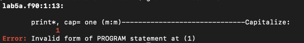

im trying to compile this program but i get this error
print*, cap= one (m:m)------------------------------Capitalize:
Error: Invalid form of PROGRAM statement at (1)

The error you show doesn't agree with the code you listed. The compiler is complaining about this line print*, cap= one (m:m)------------------------------Capitalize:
but there's no line that looks like that in your code. My suggestion is to save your code, and then recompile, and see if you get the same error again.
i did just as you requested and still got this
Here's what I would try -- remove all spaces from the label 5 in your format statement.

Older Fortran versions were very picky about what could appear in a given column. Perhaps your compiler is complaining that the label for your format statement isn't in the right place.
You could also get rid of the format statement completely.
Fortran:
read *, str
