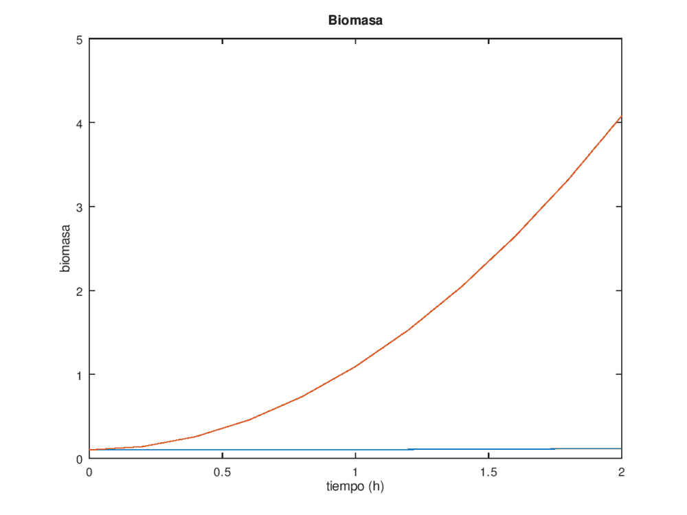

I am trying to imitate a model of differential equations in Matlab about G proteins but I can not achieve it.
-d/dt=x2
d/dt=x1
WHAT HAPPENS IS That I need to model the example of A Protein G example, using a function f in Matlab, but when I execute the script, the graphics I get do not correspond to those of the example.
The problem is that I can not understand what the model seeks to represent, besides that I do not know if my script is correct.
The function is the following:
Matlab:
function dydx = examenisb (x,y)
ki = 1;
ku = 1;
global Km1;
global Km2;
V1 = y(2)*ki*x(1)/(Km1+y(2));
V2 = y(1)*ku*x(1)/(Km2+y(1));dadx = V1-V2;
dbdx = -V1-V2;
dydx = [dadx -dbdx]';
The scrypt is this:
global Km1;
global Km2;
Km1=.001;
Km2=.001;
[x,y]=ode45(@examenisb,[0,2],[0.1 0.1]);
plot(x,y);
xlabel('tiempo (h)')
ylabel('biomasa')
title('Biomasa')

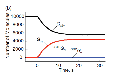

The section of the PDF is that of 3.2.4.1 G proteins

Hello,
Not an expert, but I tried your function and it does something (at least in Octave).
If this is the same picture you get (which you did not post -- why not ?), it isn't corresponding to the example (which you did not post -- why not ?)
243504
Do we have to guess which variable in the example corresponds to which variable in your script ?
Do you know how to work with break points to check what is going on ?
I notice you do v2=-... and then dydx = - ... minus sign twice ?
Note: your post looks a lot better when enclosed in ##[##code=matlab##]## ... ##[##/code##]##

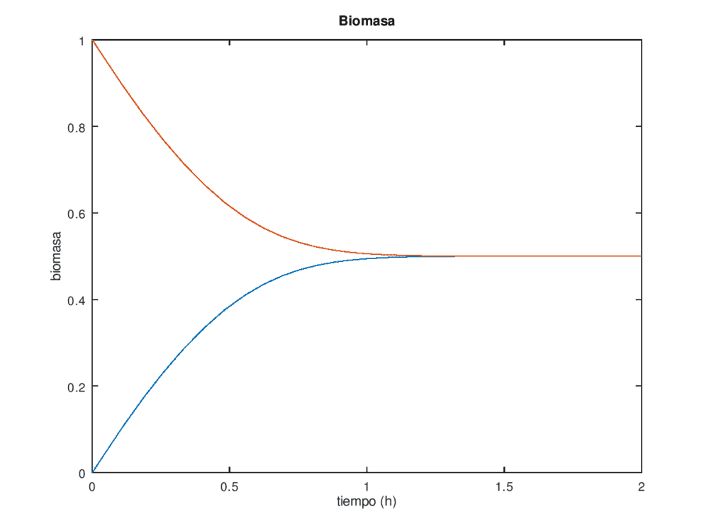

Ah, I see: you want something like fig 3.13 (b) ?
Your values now are such that V1 = V2 so one derivative is 0 and stays 0.
The other is so small I suspect a scale error (units?)
With y0 =[0 1] instead of [0.1 0.1] :
Matlab:
[x,y]=ode45(@dydx,[0,2],[0 1]);
% and
ki = 1000;
ku = 1000;
global Km1;
global Km2;
dbdx = -V1+V2;
dydx = [dadx dbdx]';
I get
243507
Looks better eh ?

THIS GRAPH
