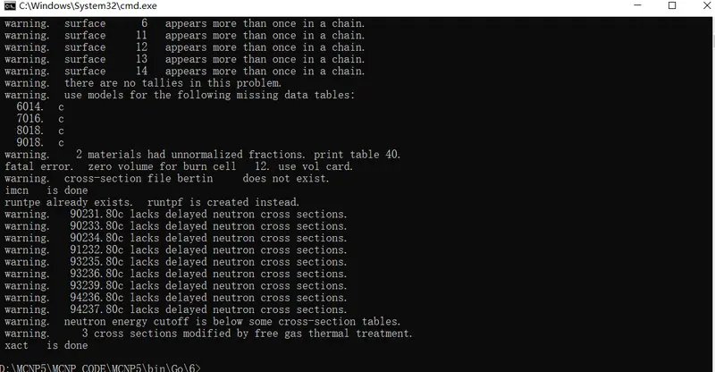

I tried to write the MCNP code for a South Korean SMART reactor and wanted to do a burnup analysis of it via MCNPX, but something went wrong
This is my mcnp code:

Hi @Unique empire, welcome to PhysicsForums.
Just a quick attempt. Cell 12 is inside cz 0.4369, and this is infinite. It's later limited to 2 meters long I think. Work out the volume and put it in the cell definition.
Code:
12 7 -10.17 -51 vol= u=4  imp:n=1
Don't just read the command line messages, read the output file.
