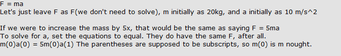

A man pushes an empty 20kg cart as hard as he can and the cart accelerates at 10m/s. The cart is then filled so that the weight is 100kg. How much acceleration can the man achieve pushing the full cart? (Show all your working)
Hi that's the question i need to do I've done most of the working out i just don't understand the algebra in it and where it goes so if someone could fill and algebra out for me that would be great
ive added a attachment with the working out I've done so far.
  • Handwritten-style working in plain text: F = ma; F left as F, m initially 20kg, a initially 10 m/s^2; mass increased 5x equals F = 5ma; setting equations equal gives m(0)a(0) = 5m(0)a(1), with note that parentheses are subscripts.
You have two different accelerations so call them a and a'. You have F= ma and F= (5m)a'. F and m are the same.
He has acceleration as different, in the attachment at least.
It's fine what you're doing so far, but in my head, it works better by finding the force using Newton's Second:
F=ma -> F=20*10
Then you can plug it into any other equation as the force value, and you can get acceleration for a known mass (or mass for a known acceleration).
