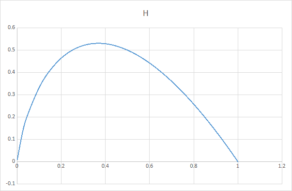

Shannon Entropy (H(x)) = - Σ P(x) log2(P(x))
NB the base of the logarithm is dependent on circumstance; ie base 2 for binary, base e for thermodynamics.
Entropy is a measure of how compressible the data is since completely random string is not compressible. Compression ratio (CR) = H(set)
H(max.)

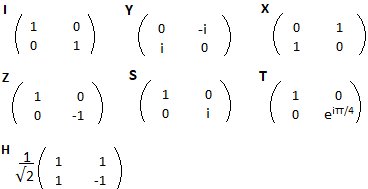

The basic qubits are:
The standard single qubit gates are the identity (I); the three Pauli rotation matrices (X, Y and Z); S, T where S = √Z and T = √S; and finally the Haddamard gate (H).
There is an additional identity: H = X + Z which implies HZ = XH

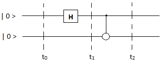

An example of a conditional gate is the controlled not (CNOT) gate, seen below in circuit and matrix form:
This gate flips the second qubit if the fist is | 1 > but otherwise leaves things unchanged.
This elementary circuit is extremely useful:
It is instructive to rewrite these in standard ket form - noting the above convention, so:
| 00 > → = 1 (|00 > + |01 >)which shows that these states are a superposition.
√2
Then, 1 (|00 > + |01 >)→ 1 (|00 > + |11 >)
√2 √2
The final ket can be recognised as | Φ+ > one of the Bell states, so this is an entangled state.
Explanation: at t1 knowing that the first qubit is in state | 0 > means there is a 50:50 split between the second qubit being | 0 > or | 1 >. However, at t2 knowing which state the first qubit is in then gives the state that the second qubit is in.
