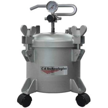

This is a photo i found that has a really similar design to the one i am currently working on.
Would you think that swing clamps could work. Or if I swap the current materials for the nut and bolt with some composite
Not sure if it would work for your application, but since this looks like a pressure cooker, how about looking at other types used there, perhaps different, stronger materials will need to be used.. I'm thinking of the type where you turn the lid and it tightens down in 1/16th of a turn or so.. Just another thought.

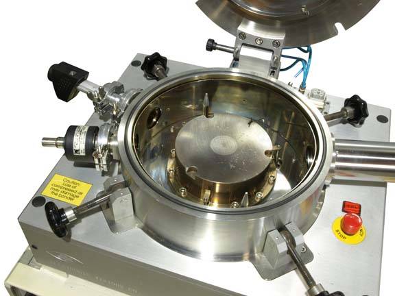

Hello and for the first time many thanks for reading
I have already asked something similar, but now I have a picture which helps to better understand what I mean.
Below is a lid which is loaded (in my case, which is similar to this) with 60 kN and the 4 clamping units keep the lid closed while a process is happening inside.
I have the task to find other clamping units, which are also manually operated, but have less to no particle generation compared to the star grips and threads.
What would you experts recommend? And again, thanks for reading this

One alternative you might consider is a rotating "breech lock screw" interlocking thread design with appropriate hardfacing on the contacting dog faces.
For a typical example of this type of design using a separate locking ring used on autoclaves see:
http://www.wsfindustries.com/rapidoor.html
Redesign the threaded clamps to use a ball screw with circulating ball nuts (follower). Add a sealed thrust bearing at the bearing surface between the clamps and lid. If needed, the pivot point of the clamps (where they attach to the vessel) could have sealed roller bearing installed. This would probably not be needed because there is very little force on them when they are pivoted out of the way.

Yes it's quite similar to the one I am working on and the 60kN consists of all forces already summarized
If I understand the direction you are going; then, one issue with a ball screw design for the screws is that it will require a locking feature on each screw to keep the screws from backing off under load. i.e. It is the friction on normal screws that prevents them from loosening under load.
