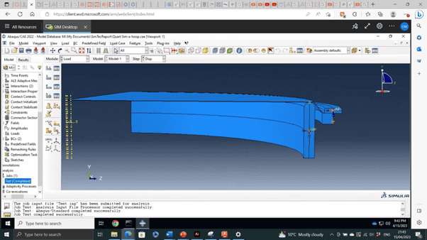

I am currently designing an alternative to normal acoustic drum lugs and I need to find the forces that are felt by the tuning rods of a drum for the engineering background to my design. I have been able to use the 2D wave equation assuming uniform tension on the membrane and found values of the radial tension in the drum head based on the ideal fundamental frequency for the drum in question. However, I am stuck translating this radial force to the vertical reaction force felt by the drum hoop at the boundary and then to 6 tuning rods, or how I would go about finding this. There are lots of resources online for finding the tension on ideal circular membranes but I cannot seem to find anything that looks at the drum hardware. I have been able to use Abaqus CAE to create a model of the lug frame I have designed but I just don't have any force values to input.

So I am not currently looking at the vibration in the skin, the purpose of the wave physics was to determine the surface tension at the boundary to produce X Hz f01 frequency in the centre. I have been trying to model the solution in abaqus with an experimentally determined downwards displacement of the hoop of 1mm, stretching it over the rim. I have linked an image. Is it possible to theoretically determine the reaction force on the hoop knowing that downwards displacement of the skin, the elastic modulus of the material and the angles and lengths of the skin extrusion to the hoop?

According to post #4 there is little or no tension in the skin till the rods are tightened so to first order assume all the tension is from the rods. Then take your value for the tuned drumhead tension and multiply that by ##2 \pi## and divide into six parts, one for each rod. That should be the approximate vertical force on each rod. I would assume the force on the rods is essentially vertical and not worry about the 45 vs 90 degrees for now. A rope on a pulley changes direction over some radius as well. Then you can work on doing a more detailed numerical simulation.
