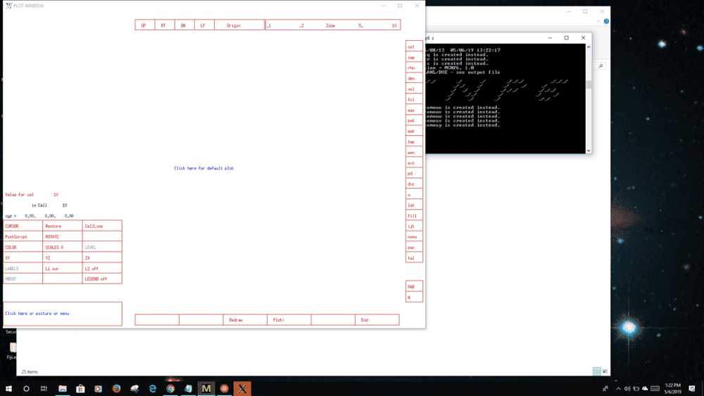

I have changed the deck with your suggestions and I am still getting the no tally no plot error. The mdata file does contain information so I don't know why its not plotting. Using Xming.
When you are in xming I suppose you are in "MCPLOT"
if yes, type "PLOT" and try again.
Another suggestion, instead of "CORA1 0 10i 10" try with "CORA1 0 10i 1" because the radius of your sphere is 1 cm not 10 cm.
Tried what you advised and still nothing. I attached a screen shot of what the plot window shows

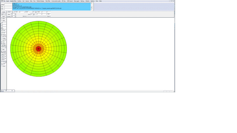

I will try to write a tutorial
One more question. How does one get the tally data from the TMESH in a way that is similar to the output of a normal F4/F6.. tally. What I need is flux in each mesh bin for example what is the flux at each cm from 0.5 to 10 cm or the angular flux in 1 degree increments.
Awesome thank you so much! So is there a way to get the angular bin data in a table form?

yes, you can use "Gridconv" for that
I used it, but the output is not in a form that makes sense. No descriptors or labels on the data just unformatted numbers.
Yes ! Mesh tally files are not well documented
To understand the file it is necessary to work in 1D (and not in 3D)
For that you can put in your MCNP file :
SMESH1:p
CORA1 0 100i 1
CORB1 .0001
CORC1 .0001
ENDMD
In this MESH tally you will have 100 intervals for the radius and only one in phi and theta.
with "gridconv" the ASCII file is essak.txt
the file essakcomment.txt is commented.
It gives :
