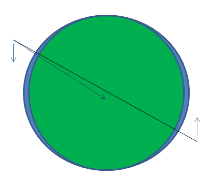

Hello, the artificial satellites that orbit the Earth with an orbital inclination greater than 0 are all subject to the nodal precession caused by the equatorial bulge of the Earth at the equator.
But what I don't really understand is that at the equator the gravity is a little less strong than at the poles so how the bulge at the equator can attract and "deviate" satellites while this area at lower gravity?
Thank you!

Gravity is close to the same everywhere on the surface of the Earth. As noted by Isaac Newton, if gravity were stronger somewhere then water would flow there. He also deduced that the Earth is oblate.
Now consider a satellite x miles from the center of mass of the Earth. It will feel most gravity when above the Equator because there is more mass between it and the center of Earth, and some of that mass is closer to the satellite. Minimum gravity is felt above the poles.
First, satellites do not orbit at the equator or at the poles. These are located on the surface of the Earth and do not extend into space. The force of gravity on a person at the equator is less because the person is further away from center of the Earth than a person is when they are at the poles. But a satellite in a circular orbit is located at the same distance from the center of the Earth no matter what inclination they are in, so the force of gravity is the same. (ignoring very small differences due to the non-symmetrical shape of the Earth)
What DOES change is the direction of the gravitational pull. When a satellite is in an orbit around a non-spherical rotating body, the bulges 'pull' on the satellite at various points in its orbit, rotating the orbit around and causing nodal precession. So it's not the strength of gravity that changes, but the direction that the force points. See the following image:
Per wiki: The centrifugal force deforms the body so that it has an equatorial bulge. Because of the bulge of the central body, the gravitational force on a satellite is not directed toward the center of the central body, but is offset toward its equator. Whichever hemisphere of the central body the satellite lies over, it is preferentially pulled slightly toward the equator of the central body. This creates a torque on the satellite. This torque does not reduce the inclination; rather, it causes a torque-induced gyroscopic precession, which causes the orbital nodes to drift with time.

I'm saying that a satellite in a circular orbit experiences virtually no difference in gravitational pull anywhere in its orbit, because it is the same distance from the center of the Earth at all times. This is in contrast to someone at the equator or at the pole, both of which are on the surface and thus have to be at different distances from the center of the Earth.
Note that while it is true that over the equator there is more material closer to the satellite, it ignores that the bulge on the opposite side of the Earth is further away from the satellite than it would be if the Earth was a perfect sphere. This means that the distant bulge attracts the satellite with less force. The net effect of the bulges is that they cancel each other out as far as I know.
Sphere said:
For a satellite in circular polar orbit around the Earth, can the equatorial bulge also cause a slight acceleration of the satellite as it heads towards the equator and a slight deceleration as it moves away from it towards a pole? (I hope my question is understandable)
Yes, that is my understanding as well. For a circular orbit, or rather a near-circular orbit since we can't have a circular orbit if we have changing forces on the satellite, I think these effects end up cancelling so that the orbit doesn't really change on long time scales, but I'm not certain.

But then does the equatorial bulge of the Earth cause the nodal precession simply because part of the mass at the equator is raised and pulls the satellite a little more towards the equator than towards the center of the Earth or because there is a little more mass at the equator than at the poles and this causes a slightly stronger gravitational force on the satellite in orbit when it approaches the equator and deflects it or else a bit of both ?
I think it's a bit of both. But again, I'm not an expert in this area, so I could be mistaken.
