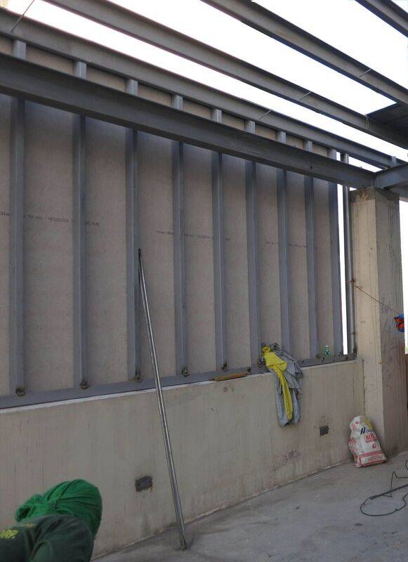

How about double sided 9mm cement board that is waterproof? It has steel structural framing already and no issues with support. What else are 4 hour fire rated material besides Asbestos or gybsum. Don't want to use thick concrete. No other material on Earth can do it? How come?
Perhaps it is irrelevant in your case, but I would like to note that the international building code maximum requirement for exterior walls of certain category buildings is 3-hour rate.
The difficulty on achieving that rate or greater is not in the wall itself but in the openings of the building (doors and glass windows), as well as the connection to the roof (parapet or overhang).

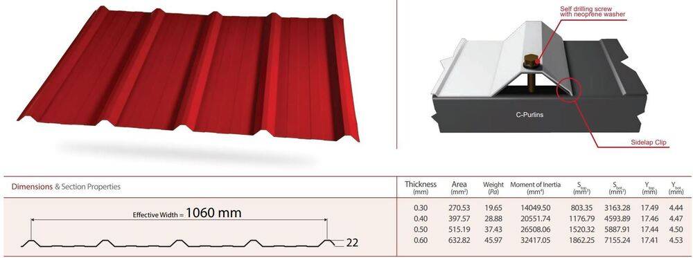

Thanks for the references. Do you have idea how long it takes before a 0.5mm thin metal roof (like photo above) can burn through in case of a fire? Any videos or photos of what occurs to such roofs after a fire?
And if fire coating is put underneath, how long it can last?
Hot enough fire (around 1500 °C) will go through that panel in little time, badly deforming it first.
Even if not, radiation from the red steel could ignite any combustible material that may be close enough.
With insulation, I have no idea, sorry. :frown:
One thing to consider is the pressures that any wall is loaded with because the air movements that the fire induces, sometimes associated explosions, inside or outside a building.
That is one reason for more resistant panels made up of different layers and an internal structure (wood or steel).
