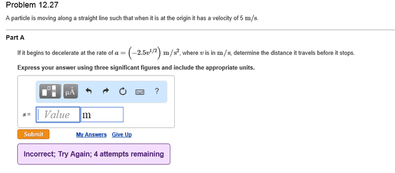

A particle is moving along a straight line such that when it is at the origin it has a velocity of 5m/s. If it begins to decelerate at a rate of a=(-2.5v^(1/2)) m/s^2, where v is in m/s, determine the distance it travels before it stops
I integrated the above expression twice with respect to time, to get an expression of s=(2(v^(5/3) t^2))/3+C1+C2. Where C1 ns C2 are constants. I've ended up with more variables than I have the know how to handle. I don't know what to do with the initial velocity. I thought of integrating with respect to v but it didn't make sense. Please help.
You should show your work.
How did you wind up with two constants of integration without one being multiplied by something else?
You know that when x = 0, v = 5 m/s. Did you apply these initial conditions to determine what the constants of integration must be?
Your integral is incorrect.
It stops when v = 0, right?
Graphically, I get an answer of less than 3m.

You're correct. I lost a update to my prior post; and it's fixed now. So yes, you can start with dv/(v^(1/2) = -2.5 dt, and noting that v = ds/dt, this results in some function f(ds/dt) + 5 = t. (5 being the constant of integration, in this case the initial velocity). Again you can separate the equation so ds and the s terms are on one side and dt and the t terms are on the other and integrate again.
You can use the distance traveled as independent variable instead of t. dv/dt=(dv/ds)(dv/dt)(ds/dt)=0.5 d(v2)/ds.You need to integrate with respect to s.
ehild said:
You can use the distance traveled as independent variable instead of t. dv/dt=(dv/ds)(dv/dt)=0.5 d(v2)/ds.You need to integrate with respect to s.
If using chain rule, shouldn't that be dv/dt = (dv/ds)(ds/dt) = v dv/ds ?
Yes, it was a typo, but the last formula is true. a=dv/dt= 0.5d(v2)/ds.
OK, but is it any simpler than just continuing with the chain rule result:
$$v \ \frac{dv}{ds} = -2.5 v^{\frac{1}{2}}$$
$$v^{\frac{1}{2}} \ dv = -2.5 \ ds $$
Which only requires a single integration, while the previously mentioned equation
$$\frac{dv}{v^{\frac{1}{2}}} = -2.5 \ dt$$
requires two integrations.
As for the constant(s) of integration, the problem states that v = 5 m/s at t = 0 and s = 0, and that the initial position is s = 0, which allows you to solve for the constant(s) of integration with either approach. I got the same result for s using both methods.

If anyone is curious the distance is
$$\frac{4}{3} \ \sqrt{5} \approx 2.981424 $$
