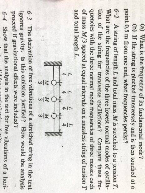

A string of length L and total mass M is stretched to a tension T. What are the frequencies of the three lowest normal modes of oscillation of the string for transverse oscillations. Compare these frequencies with the three normal mode frequencies of three masses each of mass M/3 spaced at equal intervals on a massless string of tension T and total length L.
v_n=(n/2L)*(TL/M)^(1/2)
The first part is trivial not sure where to go on the second part.

The first part is simply a case of invoking the formula for normal mode frequencies and plugging in integers 1,2,3 giving.
V_1=(1/2L)*(TL/M)^(1/2) and V_2=(1/L)*(TL/M)^(1/2) hence nv_1 (n=1,2,3) second part I assume is a case of dividing the string up into parts as per the attached photo but cannot see how to derive the correct solution of 0.84v_1, 1.55v_1 and 2.54v_1

So what are the forces acting on each mass as a function of the transversal displacement of the masses?
I am unsure are you able to provide any assistance on this. The force will likely involve the tension in the string and be a function of the angle at which the string makes with the horizontal.
So, look at mass 1. What are the vertical forces acting on it in terms of the tension and the angles of the strings? Can you find a way to express the angles using the positions of the masses?

Your ideas about the forces on the masses are good, but you need to start working with them and converting them to math so we can understand where you really get stuck.
